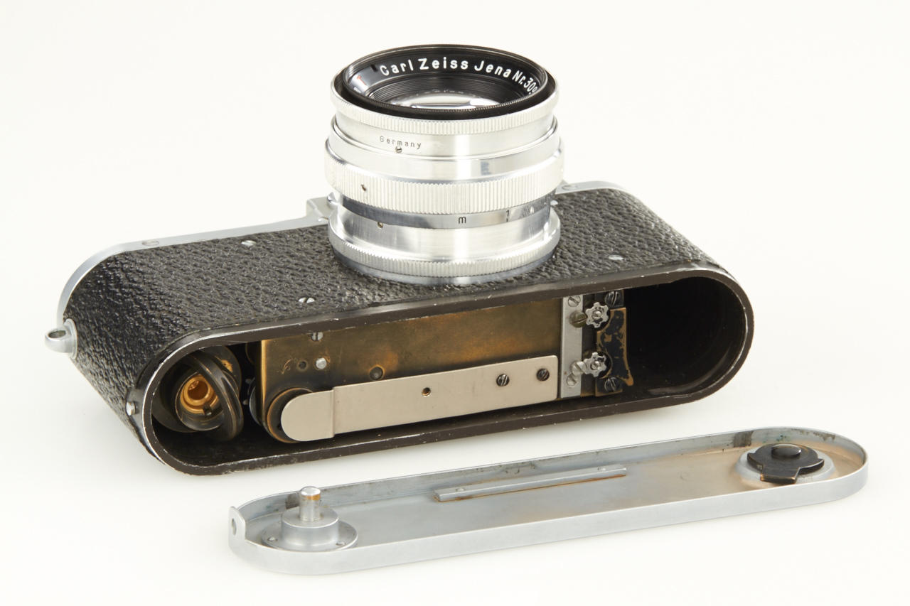

just to let you know, there was a Canon 50/0.95 lens sold at westlicht auction for 2200 euro.
Hi Lenny!
Thank you for the information
I bought mine 1450 euros for body and lens in Bièvres.
It has taken me half a day to négociate with seller from Denmark.
He wanted 1990 at beginning...Cool
Fred, page 6, lot 276, serial #16507, and 2200 euro was without buyers premium, now it's 2640 euro.
http://www.westlicht-auction.com/index.php?id=4
There was also a Neuca, not as beautiful as Jacques', page 5, lot 251, 6600 euro.
