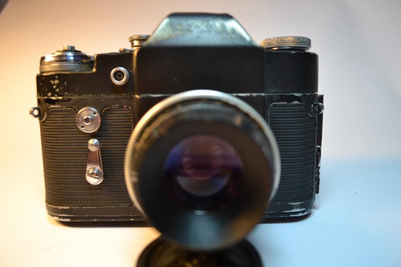

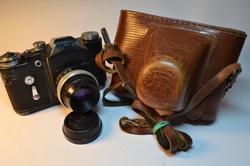

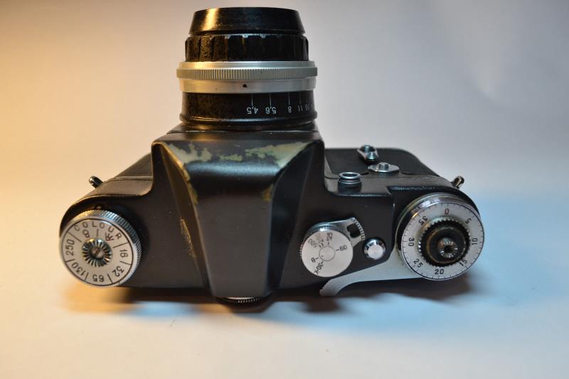

Hello all,
Wanted to hear from Zenit experts. I've purchased a curious all black body Zenit-3M which doesn't not look like it was painted and black paint is factory since you can thee from the wear underneath is brass and not chrome which you typically get when the camera is painted aftermarket. Also the absense of any kind of logo is interesting. It looks like the Zenitflex show on Aidas's site but without the logo. Anyone seen anything like this before?
The lens is irrelevant, I think someone just plugged the hole with the enlarger lens unless it means something..
Serial # is 66096018
http://www.ussrphoto.com/UserContent/20102016_s-l16001.jpg
http://www.ussrphoto.com/UserContent/20102016_s-l16002.jpg
http://www.ussrphoto.com/UserContent/20102016_s-l16003.jpg

And as Juhani had said, the fact that "COLOUR" is written in latin characters on the rewind button could mean an export version.

The Zenit came today, definitely painted and definitely non-factory Sad. The seller's pictures had a yellow hue so it looked like brass but it's chrome underneath.. too much excitement for nothing Sad
Thank you Jacques! well in our hobby nothing comes without risk, so it's ok. It works great though and looks good on a shelf Smile. I paid little money for it, so that's not an issue..
