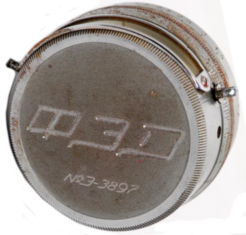

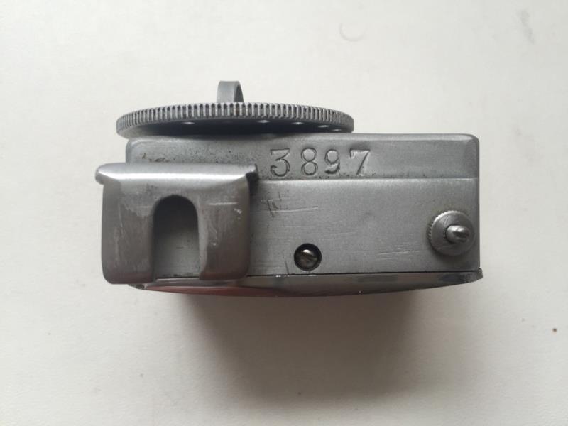

Elnur has just sent me two photos (Fed lighmeter and selftimer). They show that these two Fed accessories have the same serial number.
But the famous prefix "3" is added for the lightmeter.
So, perhaps (probably?) the lightmeters with "3" are out of the regular numbering, while those without would be inside (the numbering!Big smile)
But why? Is there a difference between the two? Or is it only a question of date of making? Any ideas?
