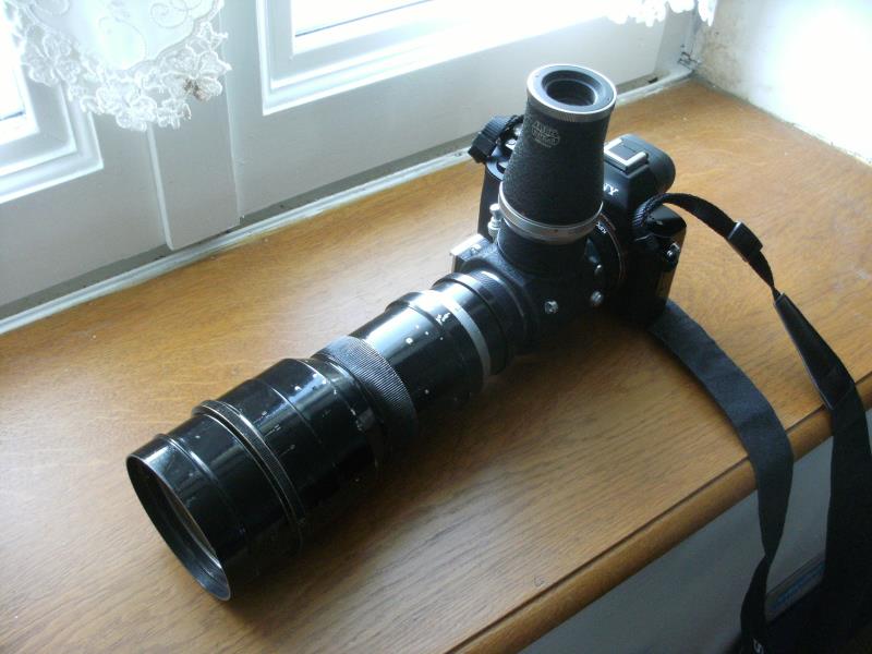

First trial on a Fed NKVD. But the position of the camera is not right with the Visoflex I. I should turn the lens plate of c.15° because the mirror of the Visoflex does not turn with its ring. Impossible. So, I will buy a Visoflex II...

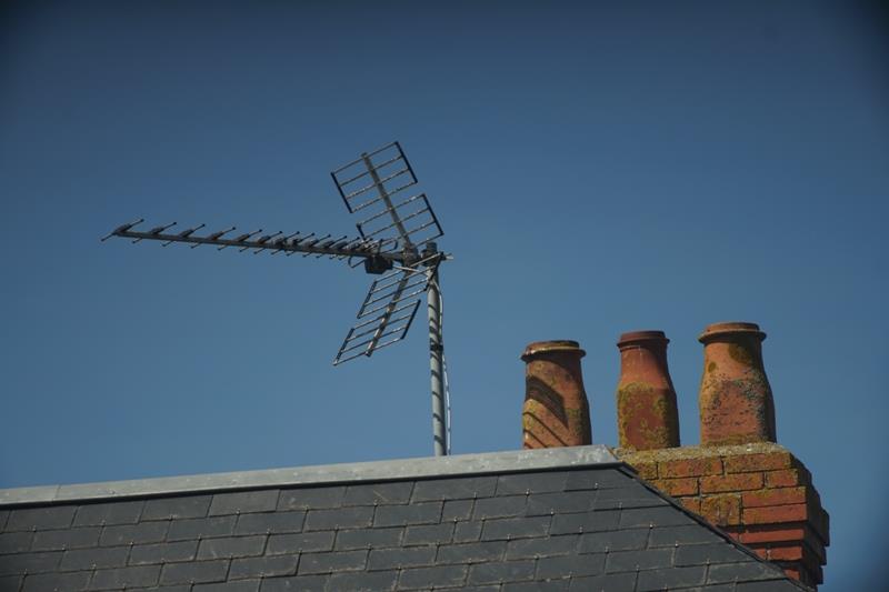

Another photo (my neighbour's roof). The vignetting is well visible.
Really, the lens is astonishing...

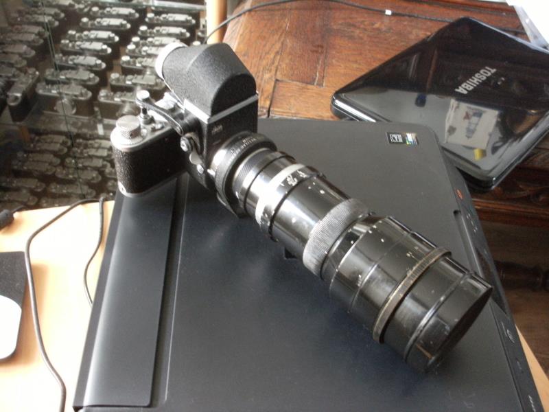

A pic lens/Viso/Sony. Uneasy to shoot with that...

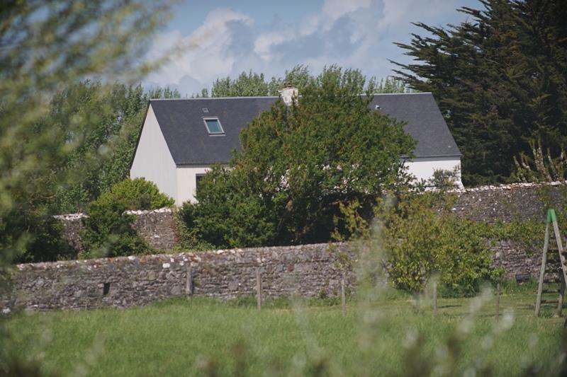

These ones are better... Always no correction, but taken on a sunny day. Less vignetting, as it seems.

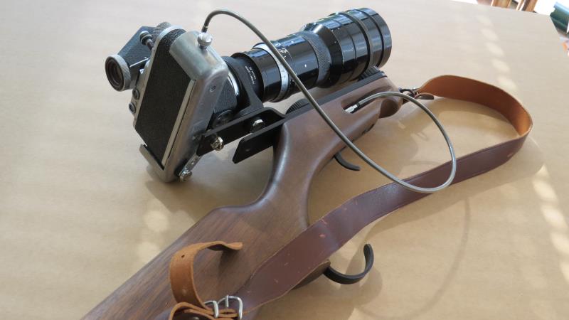

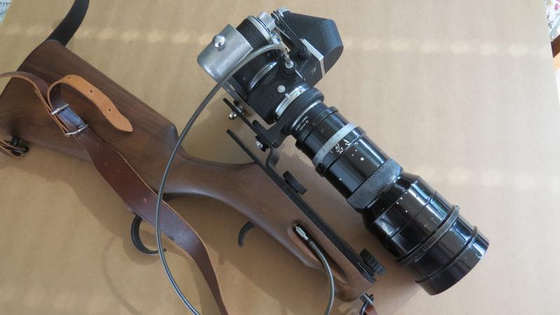

Here is "my" photosniper. In fact, an international one, with a Ukrainian body, a Russian lens, a Belorussian converter, an English cradle. I don't know for the stock itself...
A heavy and steady item... To be perfectly usable, I must soften the release mechanism, much too stiff. And for the moment, I have to dismount all the mess to load the camera! Not very fast!

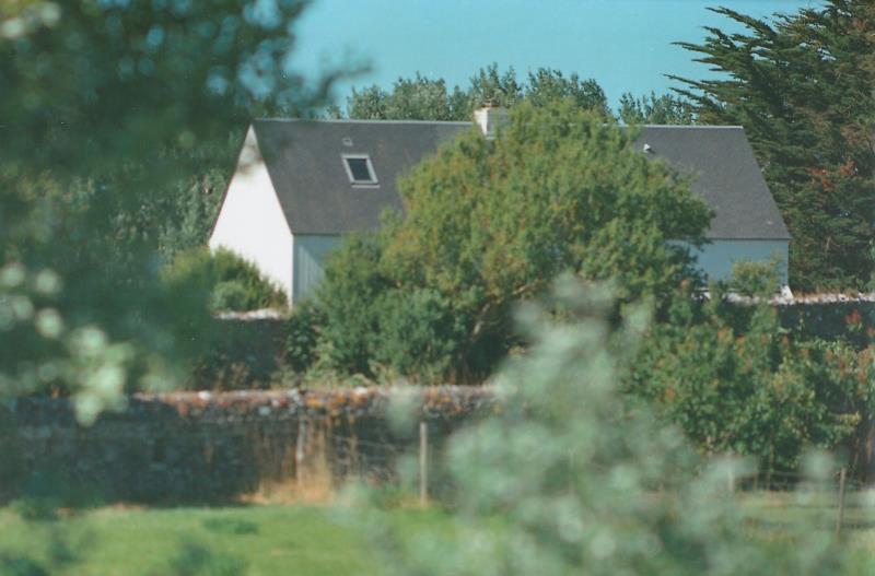

Two photos (recut: a shutter on my Fed is not in a good mood) made with "my" photosniper. Far from being perfect, but I am happy to see that infinity is there, on the first photo.
(Fuji film 200ASA, 1/60th, f 5,6).
