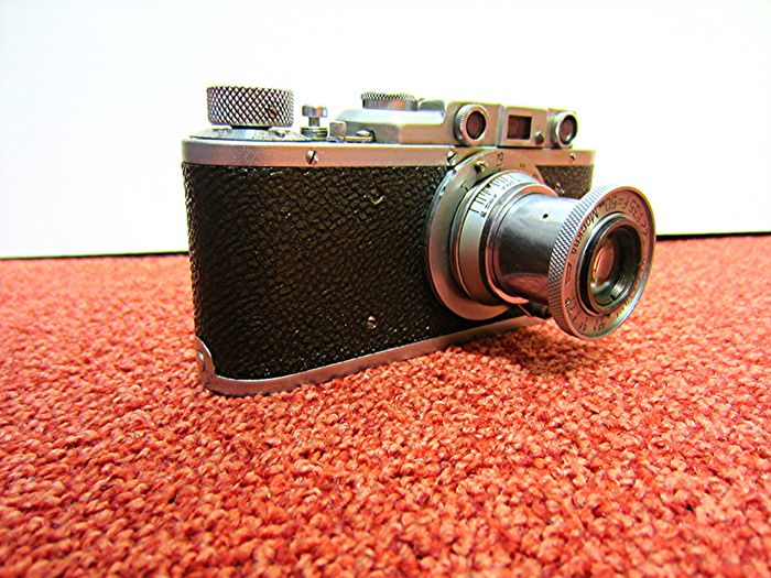

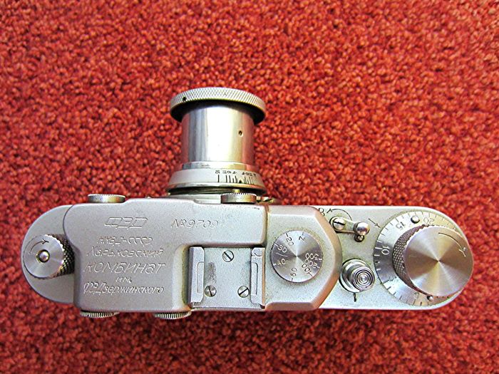

Another Fed camera with a strange number
In fact, an ordinary 1d, as it seems, but with a Fed 1b serial number.
I have no other detail about it and could not buy it: too expensive. But the explanation could be a missing cipher (s/n 97x09, for example).
