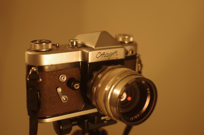

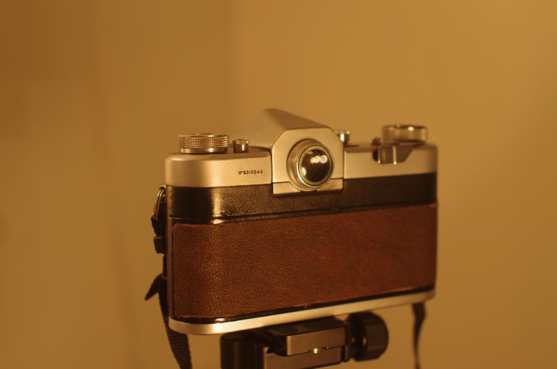

btw, my Start. I re-skinned it in brown leather, padded the cocking lever, glued an ISO wheel on top of the original markings, did a paint job (it was worn), and here it's with a Mir-1 with the M39 adapter:
http://www.ussrphoto.com/UserContent/612019_K5AB5642.JPG
http://www.ussrphoto.com/UserContent/612019_K5AB5647.JPG

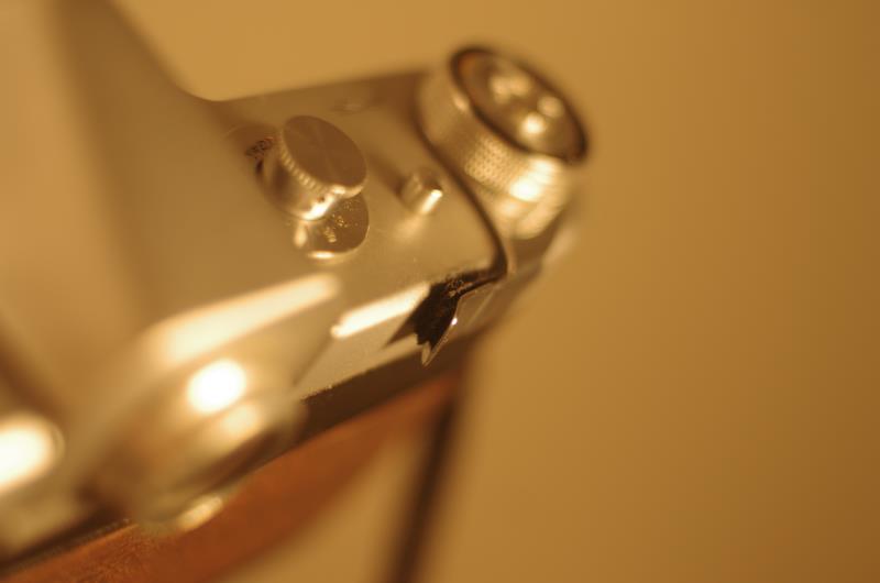

some padding under the lever:
http://www.ussrphoto.com/UserContent/612019_K5AB5653.JPG

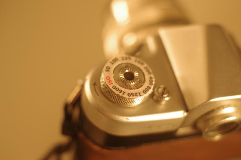

a cheap homebrew ISO circle:
http://www.ussrphoto.com/UserContent/612019_K5AB5655.JPG

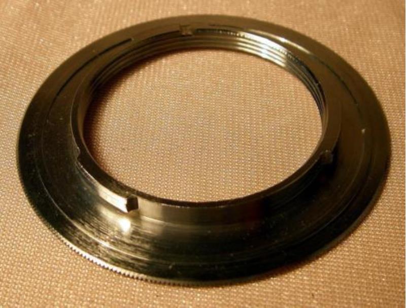

You can use on Kiev-10 only the native lenses and M39 SLR lenses with a special adapter which is not that easy to find. M42 lenses cannot be used. Servicing is difficult, it is a complex camera the the autoexposure with the shutter priority. If it is broken, it is easier just to buy a new camera. The autoexposure is based on a selenium cell, difficult to say if you can find a camera with a reliable autoexposure nowadays. Perhaps it would be better to look at Kiev-15 which uses a CdS photoresistor

As for the lenses, I use the Start with the M39 adapter, and while I am trying to make my mind about the Kiev-10, I found a M39 adapter on Ebay, that I have bought. Indeed it has to be rare, because I searched on avito.ru and found nothing(!)
the one I have found on ebay is still listed today, from a guy in Krasnodar:
https://www.ebay.com/itm/KIEV-10-KIEV-15-camera-body-ADAPTER-to-mount-M39-lens-from-old-Zenit-Kristall/312418021104
http://www.ussrphoto.com/UserContent/712019_adapter_Kiev-10_M39.jpg
