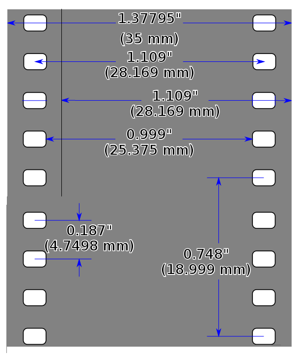

take a look at the 35mm standard film dimensions
It is easy to obtain a 28mm film

but sprockets run a full turn of 8 perforations
film will be invariably wasted
