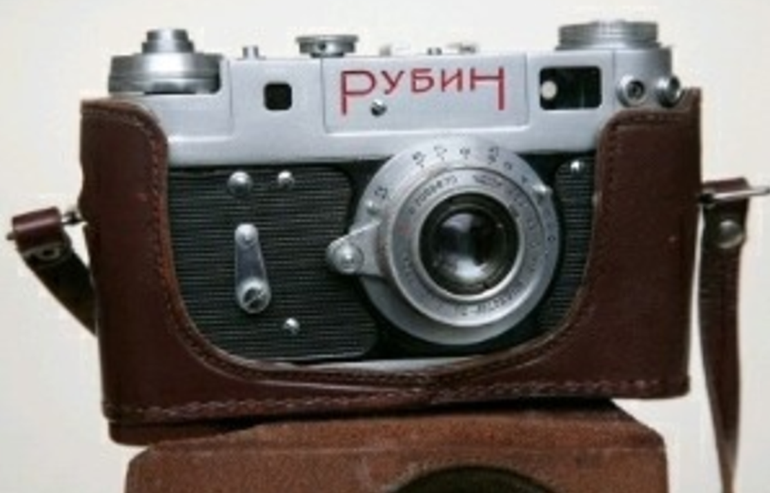

Greetings forum members. What anyone knows about this model. I saw for the first time and almost bought this model, but at the last moment the seller refused. This is the only photo that I managed to save. It is known that this model is an experimental line of KMZ, about which there is a modest record on the official website. Share the information if anyone knows anything.

Hi Denn,
yeah KMZ archive site has it on their site, it's a Zorki 5 prototype. Here's the photo from zenitcamera.com:
http://www.ussrphoto.com/UserContent2/842024_photo_2024-04-04_08-10-03.jpg
The logo differs just a little bit but that's not uncommon at all among a trial batch of cameras.
Also this camera is #8.

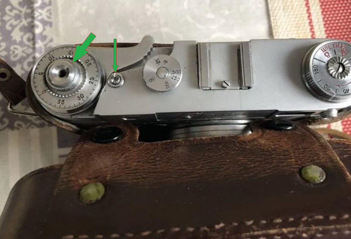

http://www.ussrphoto.com/UserContent2/942024_rubin 1.png
Observe the large and comfortable firing knob and the crown over rewind knob. best seen in the next picture
http://www.ussrphoto.com/UserContent2/942024_rubin 2.png
also the self timer inclusion absent in 1st Zorki 5 series
