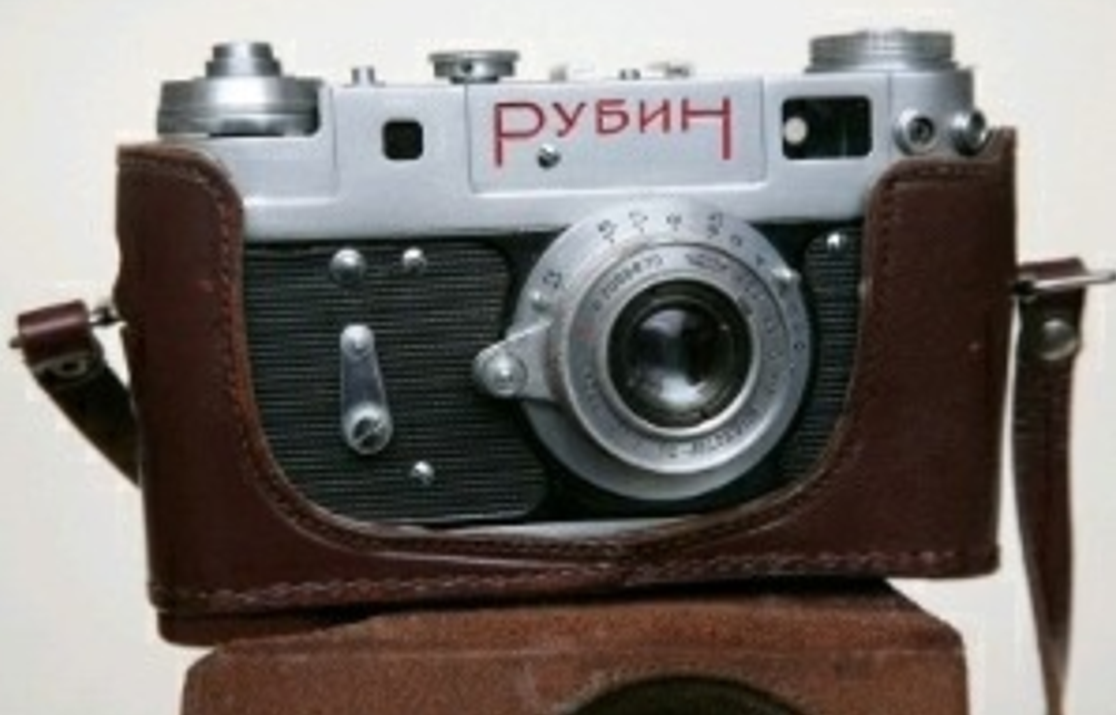

excellent find see the Ribin with self timer.
