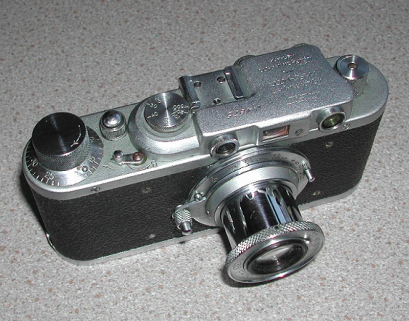

Aidas, is this camera,(1032) yours? If so congratulations! Several months have now passed since this topic was first raised, and in that time I have given this subject some thought.
It seems to me that the best explaination for the existence of these cameras is the one first put forward by Bill and supported by Jacques. That is to say that these, (Fed-1-b) cameras with Fed-1-a serial numbers are replacement cameras for faulty Fed-1-a cameras with a corresponding serial number. This latest find by Aidas also seems to support this idea.
The reasons that I support Bill's idea are as follows.
1: During the time the Fed-1-a was in production, (1934/1935) the Communards would have been young and inexperienced, and no doubt they would have made many mistakes in those early days.
2: The new tooling and machinery for making the camera parts would still to some extent have been experiencing "teething problems", and would still have needed "tuning".
3: At that time none of the workers, or Communards had yet gained any experience or knowledge of how to repair these cameras when they didn't work properly.
4: Because none of the workers yet had any experience in repairing these cameras, It would have been easier for "Fed" to simply replace a faulty camera with a new one, and engrave the number from the faulty camera on it.
5: At this time with the production of a their very first camera under way "Fed" would have been very concious that they needed to establish a good reputation, and they wouldn't have wanted negative feed back from the people who had bought the cameras.
6: All of the cameras from our own collections which show this anomaly ie, "Fed-1-a" serial number, but with a "Fed-1-b" body, would have had in all cases a serial below 55,000 if they had been part of normal production, (produced between 1935/1937). This ties in well with a guarantee period of one year for a "Fed-1-a".
7: I would guess that the practice of replacing faulty cameras with new ones would have been phased out as the Communards became more skilful, and by the time the "Fed-1-C" was in production the Communards would have learned how to repair a faulty camera, hence no longer any need to replace it with a new one.
Best wishes to all, Jim
