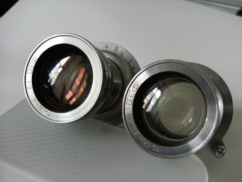

Yesterday, I received one of the last 2/50 produced, as far as I know: the serial # 32649 (to put on my 180xxx S eBerdsk).
I was surprised by the first lens which shows blue/lilac reflects which don't exist on my six other 2/50 Fed lenses, as if this one was single coated.
My question of course, is: is it possible? When?
If yes, it would be important for the understanding of Fed S 1e-s periods of making, as there is a strong correlation between S bodies and 2/50 lenses...
I didn't coated it... I swear... perhaps it came because it was hidden in my collection of T lenses ;-)
seriously I never remarked that... and it came on my FED S number 107723 but someone has mixed the lenses
Note that for me that lens was unusable, because it's out of focus in the all range...
Good luck at finding wat is wrong...
Wat if it was not a fed lens ?

No doubt this is a Fed lens!
I checked its optical possibilities: it is completely out on the complete range, as Stephan says. It's easy to compare roughly two identical lenses. This one was certainly dismantled to be repaired, and the different optic groups of lenses were badly re-mounted.
All that doesn't explain the apparent coated lens... To my mind, it's the point which could be interesting. And the specialized books don't give any explanation.
Maybe when it was dismantled and reassembled, the front element or element group was replaced with a coated element or group. Maybe that is why it was dismantled ... because the front element was damaged.

I have just partially dismantled that lens and compared it with another 2/50 lens I own: the n° 27957.
The two rear units are identical: same aspect, same convergence.
It's not the case of the front part. The 32649 is globally much more convergent. The very front lens seems more curved and thicker (I took it away), so that the ring cannot be screwed completely in the barrel to fix this lens. It's this first unit which is coated.
Of course, impossible to take pictures with this lens mounted on a Fed S or any LTM. Perhaps the work of a handyman to sell its lens? Or a trial of the factory for an hypothetic 39mm small format in 1941 or after WW2...?

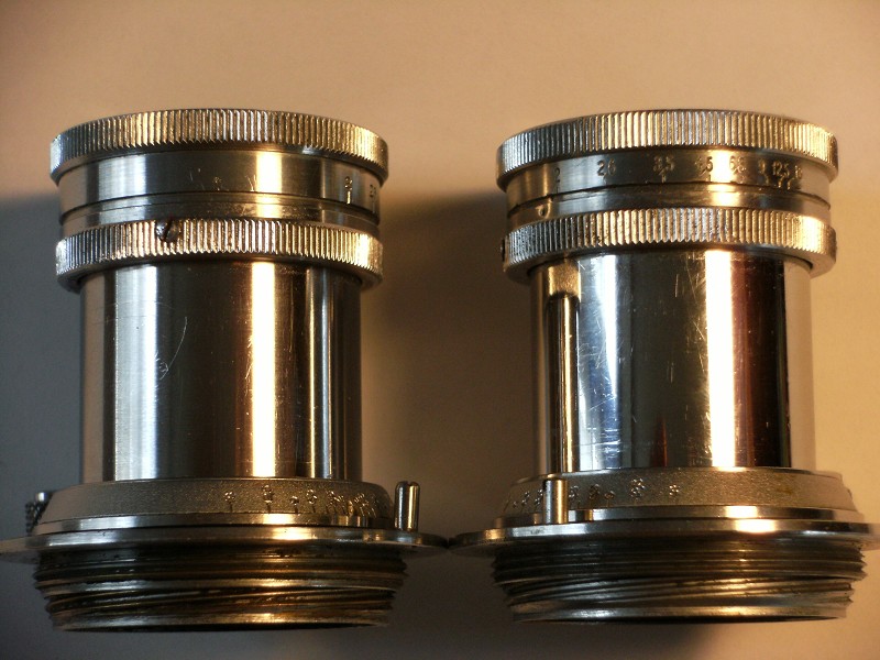

As the ring cannot be completely screwed to secure the very first lens, there are two millimeters which protrude. And the screwing aluminium cover is exactly 2 millimeters larger than the ordinary one to enclose all that. The work is perfect. I try to join a picture.
So that is hardly noticeable that the lens 32649 is very slightly larger than the 27957.
All that makes me think this lens was made by the factory. But when? And above all , why?
