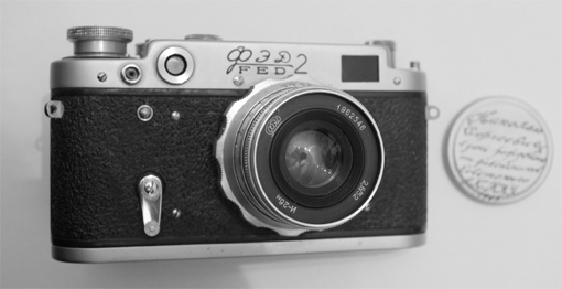

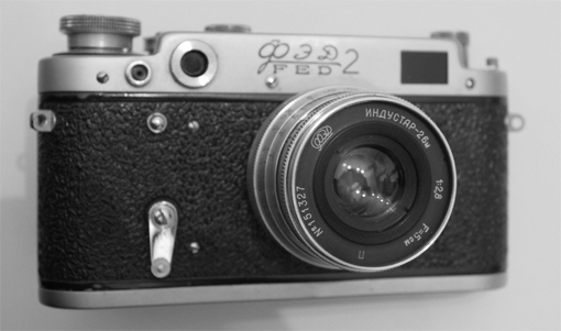

Here are for you the datas you requested :
FED 2 s/n # 3480014
FED 2 s/n # 3494114
…assuming that the lenses are matching. (No passport…)
Have a nice evening.
Amitiés,
Michel.

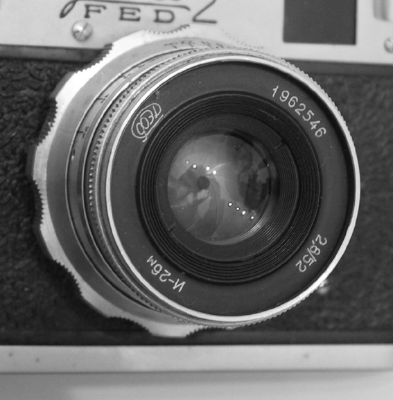

this picture seems better than the first one :
My #000200 weight is 485g.
Thanks, Vlad.
5g more, it's not significant, more especially as we didn't use the same balance. So it seems that only very early Fed 2s weigh more. Anyway, with Alain and his 007, we can expect everything...Big smile
Thanks too, Michel. Your first couple (body # 3-480014 and Industar 26m F410 # 1962546) is very interesting, to compare with another couple: body 3a # 3-202131 with 26m F410 # 1982213. Of course, we have no proof, but I think that the four items were made in 1963. The "ordinary" F410s stop at c. 21xxxxx. Afterwards, it's another story... upon which I will try to write something here when I have cleared my ideas!
So this first couple is probably original. Not the second one: the F400 should be found only with 2b-s, and your lens is one of the first ones...
