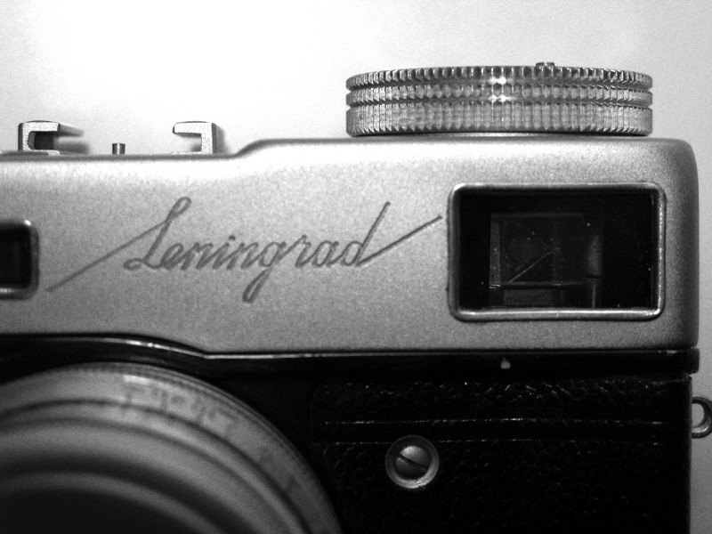

a nice latin engraved Leningrad arrived here today. I have never seen one before and have some questions to it.
The speed dial looks different from any speed dial I have seen on russian cameras, the 1/60 and 1/8 second are more engraved to the middle of the dial. Is it normal for the version with the modernized times?
The film marker and gost marker plate on the rewind dial is completly made of plastic. I have never seen such a marker plate before.
And the little plate with the two holes above the front range finder window has a groove.
By the way, it works very good and there was a roll of film in it :-)
The lens is not the original one, it came with a late black Industar 50 but the J-8 looks better :-)
Here are some pics:

Hi Ulrich,
This speed dial was used on later versions of the Leningrad, once the new shutter speed sequence using 1/60 had been adopted. The earlier one using 1/50 has the more traditional alignment. Of the four Leningrad cameras that I have in my collection, ranging from 001878 to 650334, none have the groove in the RF adjuster cap. Three of my cameras have a film speed selector like yours. Also, the film speed reminder disk appears to be aluminium in all my cameras.
An interesting find.
David

Hi Ulrich,
I join to my message a (very bad desktop made) photo of the rewind knob of my Latin Leningrad n° 61 2842.
As you can see, the rewind knob is slightly different from yours.
By the way, my Cyrillic Leningrad n° 62 2283 has the same knob.
(But none of them has the "groove"… )Sad
So, nice find.
Congratulations Smile
Michel

The grooved plate above the rangefinder adjustment seems not to be original ... I have tried to remove it (it sits very tight) and I found out that it was glued on :-( So somebody has lost the original plate and has taken another one that just coveres the hole. It does not have the two "ears" to lock it. But I have some spare Leningrad parts so I will restore it to it's original state, I think.
