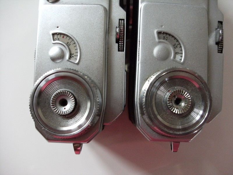

Now, a comparison between the 1951-56 Jena Contax and the Kiev # 504664. The Kiev is always on the right.
http://www.ussrphoto.com/UserContent/1222011_Jena Contax-Kiev 001.JPG

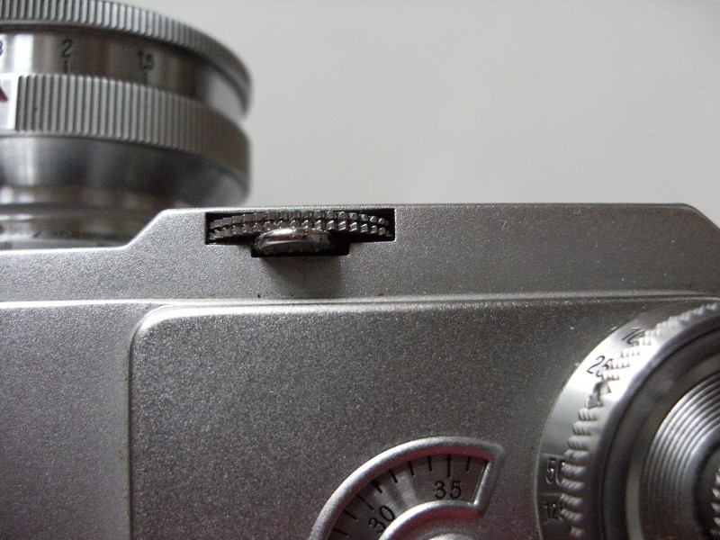

No real difference on this first picture, except for the distance wheel: no groove on the Kiev. But my earlier Kiev # 503737 has one...

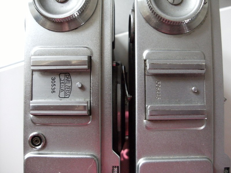

A distinctive detail on Jena Contaxes: all have a square shaped shoe. Some early Kievs have it too, probably coming from the same Jena parts. No square shoe on wartime or prewar Dresden Contaxes. The flash synch is a rare feature on Jena Contaxes. DVD says that a 1954 Kiev II preserie had it too. Where was it? On the top or under the finder?

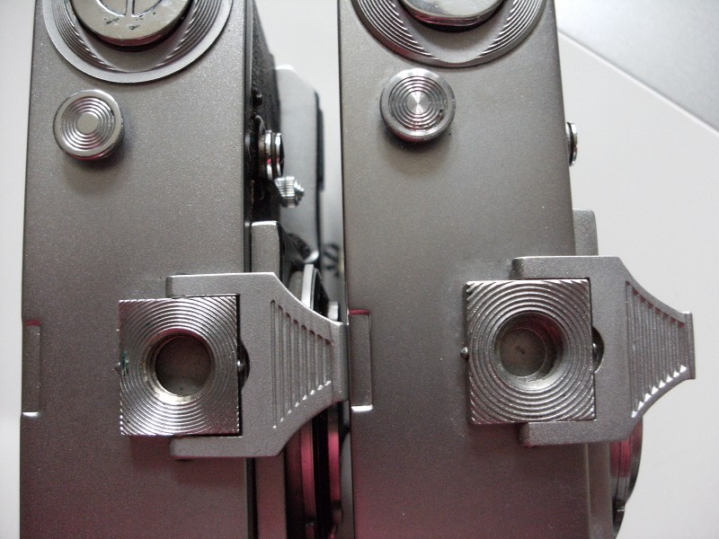

On this picture (Kiev always on the right), the release button is the same. More circles on the square part of the shoe for the Jena Contax, which seems to be a distinctive feature. The triangular part too is slightly different: more space between the lines and the rim. And if the back is much more heavier on this Jena Contax (175g against 113g for the Kiev), one cannot see it.

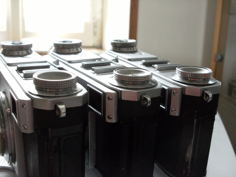

Last picture. From left to right: 1948 Jena Contax, 1951/56 Jena Contax, 1950 Kiev.
One can see that the rewind button is not the same everywhere: four rows of diamonds on the 1948, only three on the two others. It's interesting to notice that all wartime and prewar Contax II have four rows.

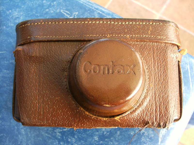

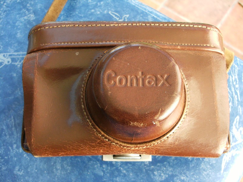

Some last pictures in a while about the leather bags of my two Jena Contaxes. Tongue
http://www.ussrphoto.com/UserContent/132011_Jena Contax bags 002.JPG
http://www.ussrphoto.com/UserContent/132011_Jena Contax bags 001.JPG
The leather bags of my two Jena Contaxes.
The first one (=upper) is the 1948 one, the lower is the 1951-56 one.
The general shape, the sewing and the nose are the same.
Prewar or wartime Contaxes don't have that sort of bag. But they can be seen for early Kievs with noses a bit different.

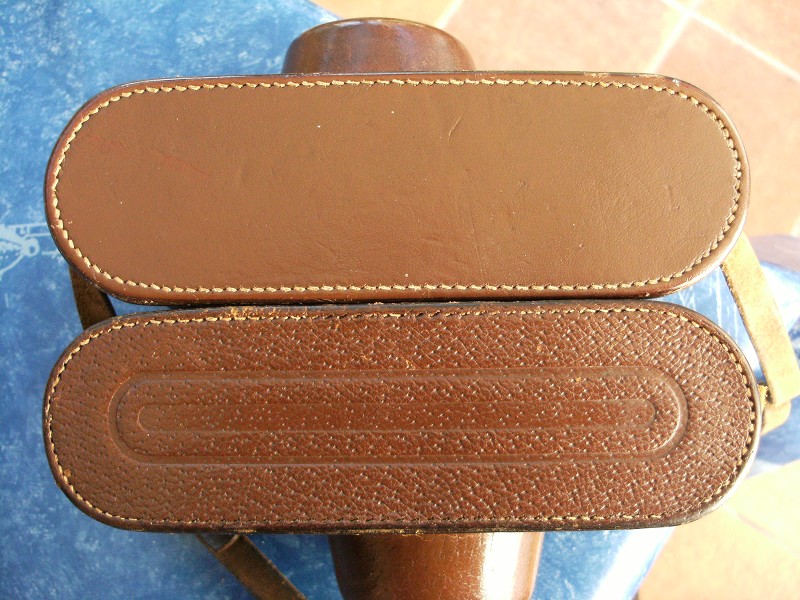

http://www.ussrphoto.com/UserContent/132011_Jena Contax bags 003.JPG
That time, the 1948 is the lower. The stiffener stripes exist only on this one. The grain of the leather is more rough.
The two qualities of leather seem to exist on the 1947 Kiev. But it must be confirmed. See for example this 1947 Kiev case:
http://www.dvdtechcameras.com/collect/arsenal/arsenal.htm
The only difference seems to be the polygonal nose rather than round on Jena Contaxes. I don't know if other early Kievs (1948, 1949) have such cases...

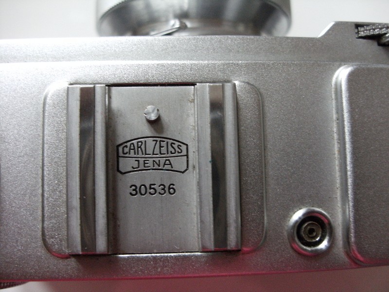

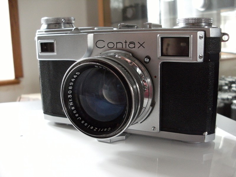

Now that I own a Jena Contax too I can confirm to all points that Jacques listed. It's a really interesting camera. Here are some pictures:
The feather on the selftimer release and the black painted ring under the selftimer lever:
The shoe with the number and the logo. An interesting detail on the film reminder disk, the digits are engraved a bit more to the inner part of it. And no flat "3":

And the result after reassembling:
Now it's a real beauty, when it arrives here the chrome on the top and front mask was a bit yellow tinted, then I found out that was nicotine (it stinks during removing it...)! So it seems that the camera was sitting the most time on a shelf in the household of a heavy smoker. That was the main reason why I disassembled the chrome parts carefully.
By the way, the lens is a rigid Sonnar in an aluminium housing. Like the Zorki lens on my Kiev II from 1949.
