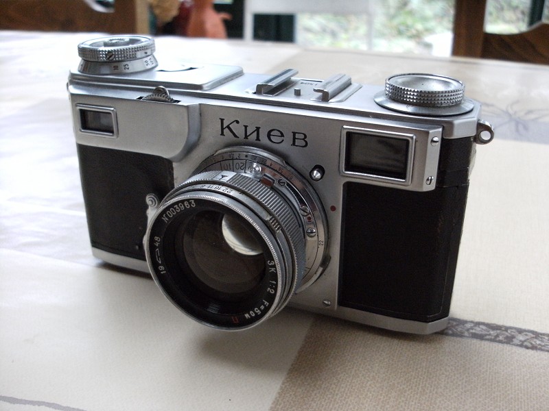

I received some weeks ago a 1948 Kiev. Here is a photo:

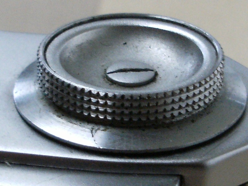

In fact, mine is most on the Jena/Kiev side: no "3" with a flat top, for example. Of course, there are Dresden arrows with a central extension. And four rows on the rewind button:
These four rows are present on all the prewar Contax II, early Kievs up to some 1949 ones, and on early Jena Contaxes (my # 30xxx doesn't have). Three rows seems the rule after.
Absolutely splendid camera !
Lucky guy…
Mine is not so beautiful, and the lens is… a Jupiter #54xxx SadSad
Sincerly,et à bientôt,
Michel

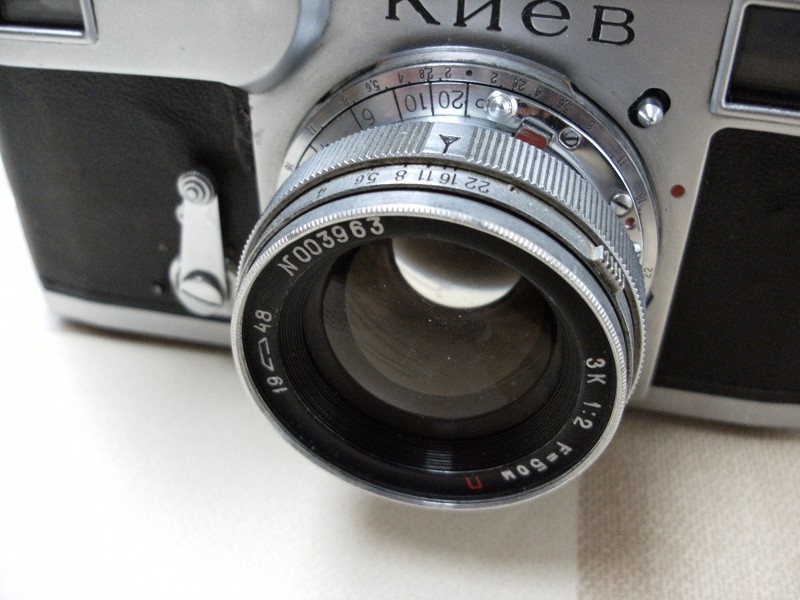

Always on this 1948 Kiev, a ZK lens. I thought till now that 1948 ones were collapsible? The numbering seems correct.
Are there other "solid" 1948 ZK that you would know?

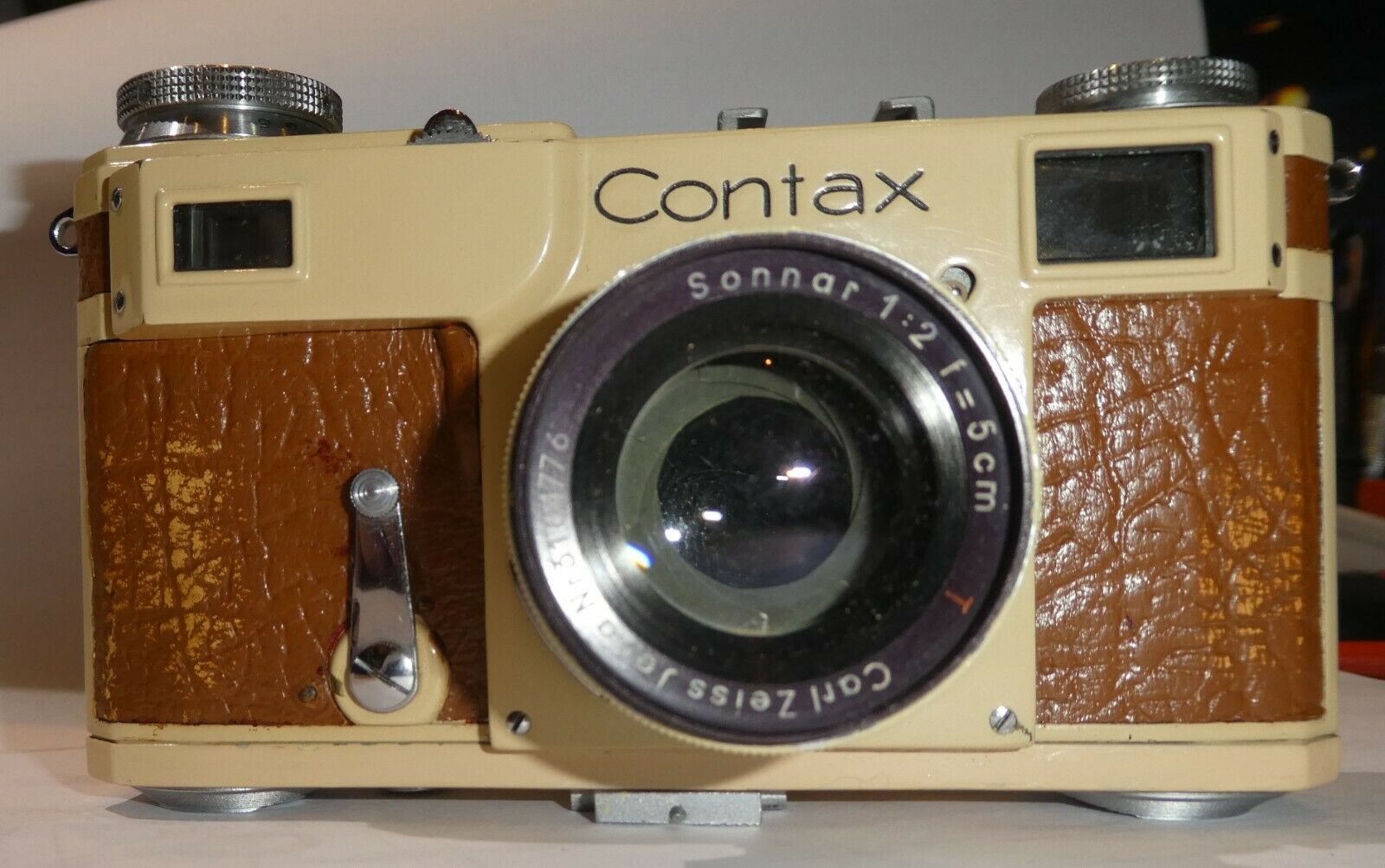

An other Jena-Contax here.
The s/n 11829, next to my 11826 already seen above in the thread.
Externally, there is only one difference. The winding button has a different shape (screw and "bowl"). Nothing else before dismounting.
The general look first:
And the curious winding button.

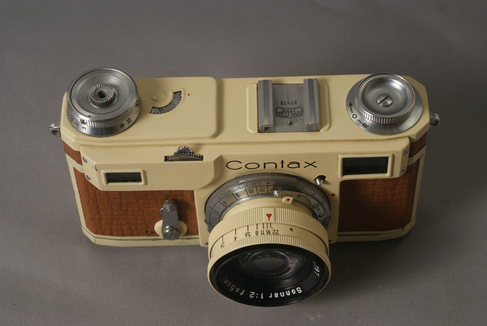

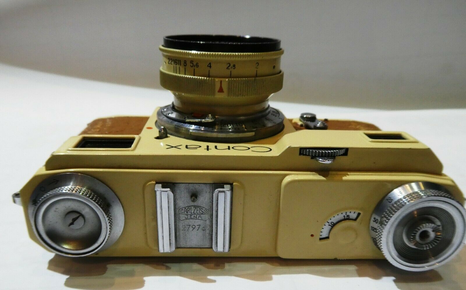

Just for the pleasure, two photos of a fake Jena Contax "ivory", recently sold on the net:
To compare with a genuine ivory one. In fact, a fake too! (please see Xatnoc's and Ulrich's posts below)

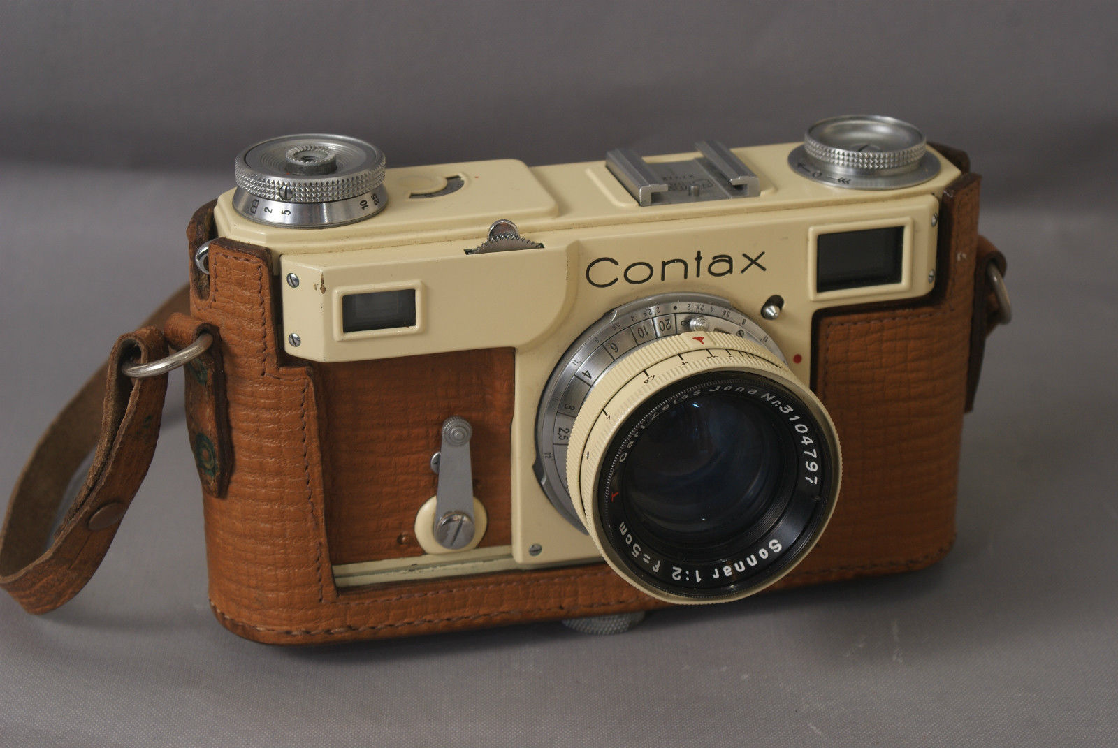

Another Jena Contax here (# 18055), already with the heavy back.
The lens is an "exotic" Sonnar, already shown in another topic.
Amitié. Jacques.

Hello everyone,
I have a concern that the ivory Contax 27972 shown in this thread above represents an authentic ivory camera. This notion is for the simple reason that the camera looks too good, the paint looks too fresh. I have followed the fate of this camera: first it was sold at a German Auction house, "Cornwall" in Cologne in auction 38, then it appeared on eBay again in 2016 where it was sold to the next owner. In my data, I also find a comment of a previous ivory Contax expert who expressed the same concern as me: looks too good. All true ivory Contax show some wear and the color starts to disintegrate. Using this criteria, any fake has a difficult position, as paint cannot be easily converted to paint that has already experienced >70 years. Similar situation as in paintings.......
