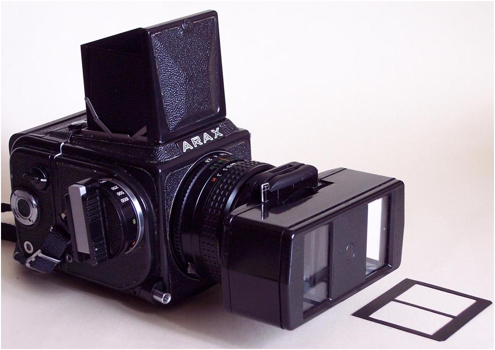

Speaking about stereoscopy, is there any stereo device produced for medium format camera ever? I'm not interested in Sputnik camera, but rather in ARAX 88. I explain.
In fact, I'm about to perform some tests with a Stitz stereo gear attached to my ARAX 88 MLU provided with a 80mm Biometar lens and a 4,5 x 6cm rollfilm back. Thus each frame will provide two shots for paralel view. The normal 80 mm Biometar is equivalent to a 50 mm on a 35 mm camera. Hope this will prove to be feasible!!
Your thoughts, please!
Interesting enough I am just now preparing a new section about stereo that will replace all our previous one, much more enlarged and including several other câmeras.
More yet is that it will enclose several researches since the Wheatstone viewer to several new digital câmeras.
Mr. Friendlyrod the well known SKF will work together Arsat (Volna 3) lenses accurately although images will have a limited horizontal field angle.
