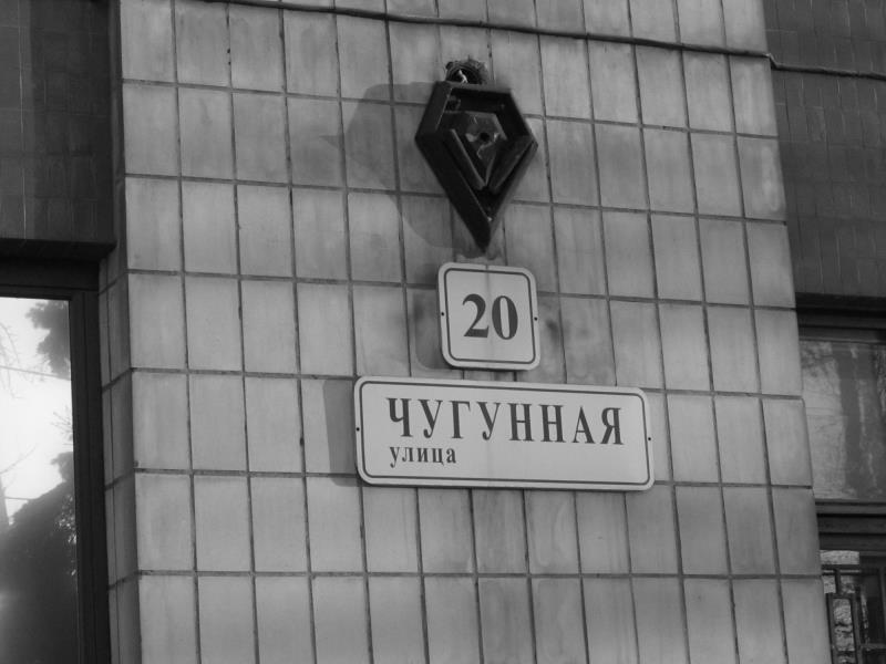

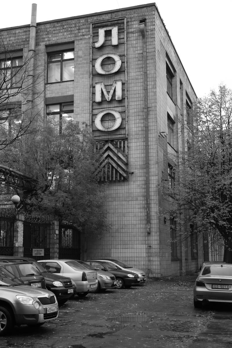

Almost all Russian versions of Smena camera were produced in Head Office of GOMZ-LOMO plant (see pictures with address and façade bellow). Starting from 1980-ties all the production facilities were transferred to a new plant's buildings (within Leningrad city again). It's important to mention, that GOMZ has transferred technical documentation of Smena, Smena-2 (and Smena-3)cameras to a new MMZ plant (Belarus) in 1957. That's why we additionally have at least 4 versions of Smena camera with Belarus origin ... Smile
