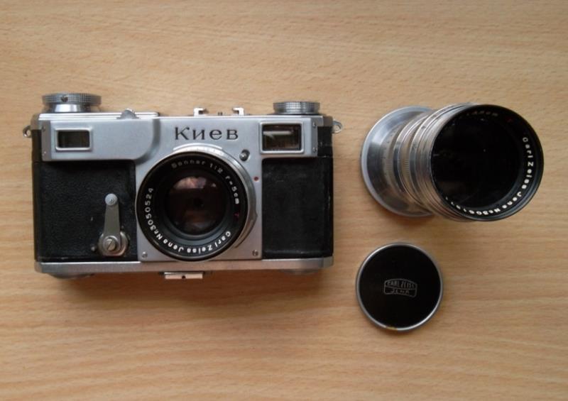

Here's some close up pictures of a Kiev II from 1953. Some parts seems from German manufacture (focusing wheel, counter dial, lens mount)- quite uncommon, that camera is a late Kiev II.
I saw this camera on ebay recently. I would say that it is Contax with Kiev front plate and serial number. The flash socket is later addition and is not like Arsenal ones. Probably modified in Hungary. Perhaps in 1953 a batch of Contaxes was discovered in warehouses of Arsenal and used in order to save time and money. There are no much cameras were released in 1953. Probably workers were too unhappy (or too happy) that Stalin died. So the discovery of Contaxes was good possibility to fulfill the gosplan.

it is hard to judge from the pictures but it seems that the chrome on the front plate is too shiny. It is unusual for cameras from 1953. It is also strange that the front plate has the rim around the bayonet in Contax style. It puzzles me. It can be that the camera body is not from 1953 (of course it is Contax, but I mean the last modification of the body on Arsenal factory Smile). Or the whole story could be a bit more complicated as I mentioned above.
To guess its origin it would help if you remove the front plate and look on the rear side. A good hint would be if you say what kind of rangefinder this camera has. Is it split as it is standard for Zeiss Ikon Contaxes? (it would be great if you can make a photo of a big rangefinder window). Definitely the camera is interesting.

Your camera seems to be from the first batch of Kievs that arrived from Jena to Kiev. They are actually Dresden Contaxes that were inspected, calibrated in Jena and with minor cosmetic changes sent to Arsenal. The absence of traces of Contax engraving on the rear part of the plate will support this hypothesis. In this case the shoe with 53 was placed instead the original shoe.
If there are some traces of Contax engraving (which I find rather impossible) it would mean that the camera came directly from Dresden to Kiev and there was modified in 1953.
Could you also share a close up of the leatherette of the camera back door?

I am almost convinced that the camera is from the very early batch of Dresden Contaxes modified in Jena and sent to Kiev. Probably the flash synchronization was done in Jena too.
The leatherette on the back is the same as on no-number Kiev I've mentioned above. Unfortunately the leather on Kiev cameras from 1953 has very similar structure. But it seems that the leather on the front is from Dresden Contax. It is curious since on no-number Kiev Dresden leatherette is only on the top thin stripe near the strap lugs.
I still don't know why the shoe with the later number appear. In order to know it I would like to ask Jed to tell me about this shoe. Is it covered with shiny chrome? Jed if you could measure the diameter of cylindrical stopper on the shoe with a caliper. This would help to reconstruct the history of camera migration.
It would be also interesting to see the camera with removed back door. Namely the closeup of flash socket connection.
