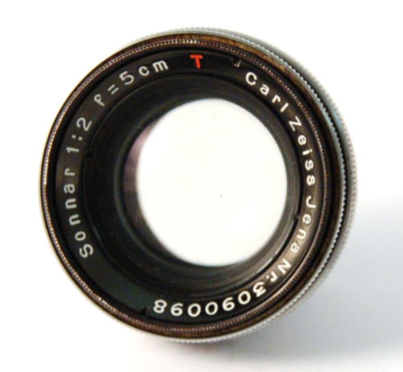

Please note that the seller of the camera sold at the same time that lens. Ebay seller just confirm to me both camera and lens belonged to the same owner.
Jed, that lens comes out of a batch of 1400 lenses which was completet on 4.12.1947 (dates from Thiele's book).
So it seems to match with the camera ? Am I correct ?
The Sonnar on no-number Kiev is combined with the camera this year. I think that cameras were delivered in Kiev without lenses or leather bags. It is quite natural way to transport such sort of goods. The lenses from Jena were sent usually to KMZ or to Leningrad. So I doubt that any connection exists between the camera and Sonnar. But it is true that the lens suits the camera body.
