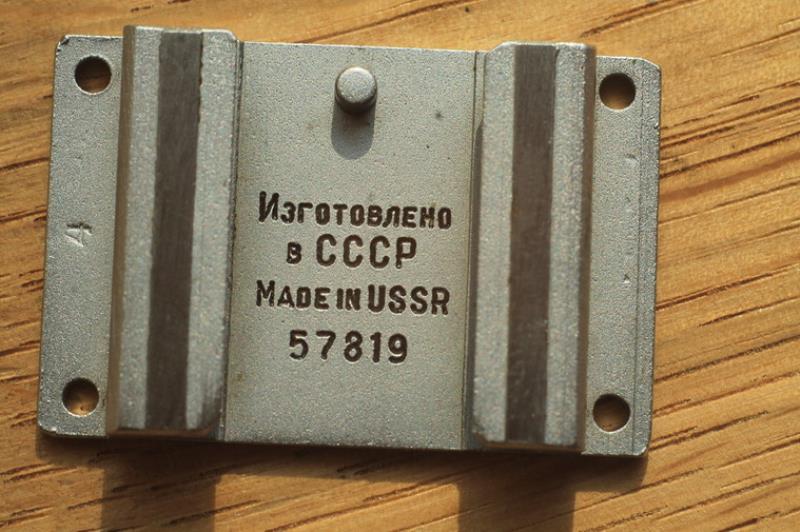

Hello to all and a happy new year!
Recently I found this early Kiev 4 with 5-digit serial number. I have never seen such a number on a Kiev 4 before, I only knew serial number with 6 or 7 digits. The lens has a matching early 57 number (5700244).

Hi Altix,
You're correct my recently bought 1957 Kiev 4 has the same front plate as that one pictured here :
To me it does not look like a defect.
These "short" numbers, for the 1957 Kiev 4, are interesting.
Would it mean a new numbering for this year?
But what do we know exactly about the numberings of these cameras? As for me, I stop in 1952!
Hi, these cameras are interesting. Suspect most know that the Kiev 4 was strongly influenced by the Contax IIIa, and an attempt by Arsenal to modernise the Kiev. Contax IIIa production started in 1951.
Re. the 57203 and 57777 cameras, it appears the top shroud of the light meter was a direct copy of the Ziess original; Arsenal added the re-inforcement swages some time after (suspect because a thinner grade of metal was used compared to Zeiss).
Jed: it looks like your camera may be a hybrid as it has the old Kiev IIa/IIIa type base, back and backlocks. That part of the redesign by Arsenal to match the Contax IIIa was not as successful as the Contax IIIa was a narrower camera whilst the Kiev 4/4A retained the basic dimensions of its predecesor. This apparently lead to film flatness issues and distortion of the back though I have not had such issues with mine.
