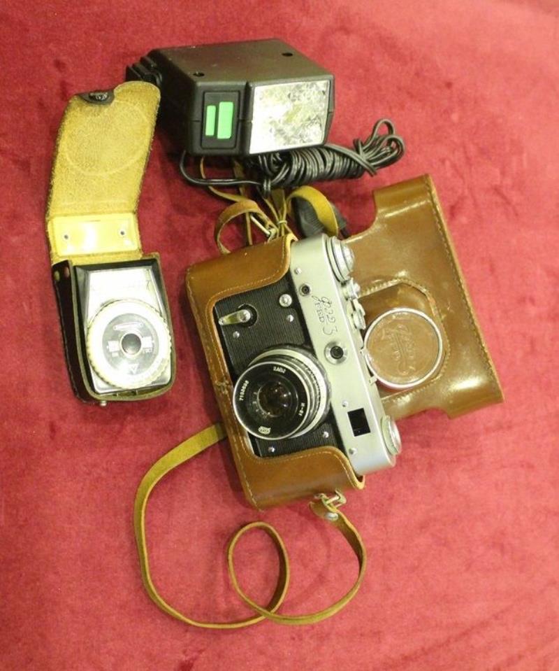

I'm liking the FED-3 on the picture, because it comes with extra gear. I get it for around 20-25 euros, so if I'll struggle with it too much, it won't be that big of a loss (I could also resell it)
Thank you, I was just wondering if something like this is a big no-no, but if it's fine, then I'll take it.
A FED-3 is also OK. But take notice cocking the shutter first before turning the shutter speeds.

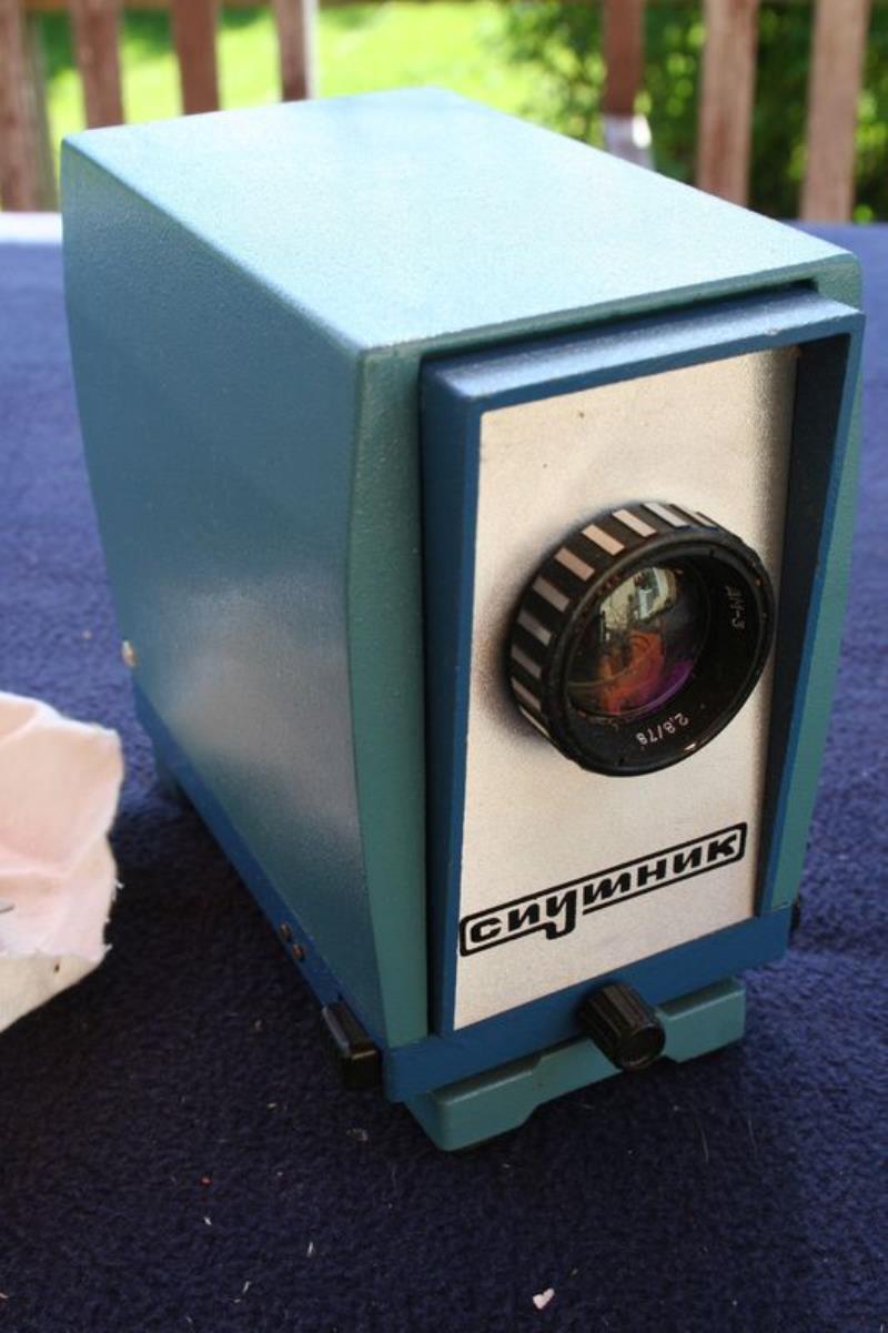

On another subject: There is this fantastic looking Sputnik diaprojector on a local auction. Sold as ''like new'' (Original box and extra gear, even has the original flanel cloth for wiping the lens. )
Now that I'm getting into this stuff, finding these gems is very satisfying!
