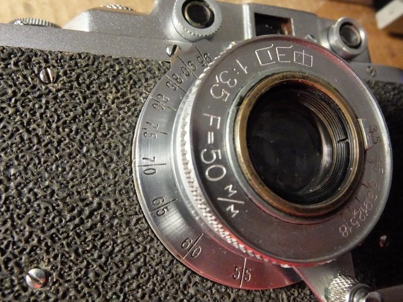

Hi all,
just got a Fed 1 with a weird (?) lens. The Industar-10 has a scale that I don't understand (from 50 to 95). It is a scale conversion calculator ?
Yes it is macro lens.
But as I can recognize by vulcanite the FED is post war camera while lens is made before WWII.
I haven't heard macro Industar 10 was produced after war.
The "rigid" macro lenses were made only before WW2. They can be used directly, with a long helicoid (but without coupling, of course).
These collapsible macro lenses were probably made in 1950 only. In fact, they are just normal lenses reengraved with a macro scale. Use with macro rings. For the moment, most of these macro lenses were found on early Fed 1f (s/n 23xxxx/25xxxx), so with an old diaphragm scale. The new one (f 3,5-4-5,6, etc) appeared just after.
As far as I know....Smile
For these collapsible lenses, see too http://ussrphoto.com/Wiki/default.asp?WikiCatID=87&ParentID=2&ContentID=456&Item=FED+macro+collapsible+Industar+10
Thank you Jacques. I thought collapsible maco lenses were made before WWII. As I can see I was wrong.
In 90's I found 2 or 3 of them mounted to FEDs NKVD. They are not coated and with old scale so I thought they were produced for FED NKVD.
Now I know more than 1 hour ago. Wink
Hi All,
Thanks !
S/N of the lens is 839. Camera S/N 242774. We may update the Wiki ;)
Camera is damaged, body is deformed. I was planning to take it apart for other repairs projects...
Please, update, Jean!Wink
Perhaps it would be interesting to keep the camera and the lens as they are: it is a relatively rare kit. But it is only my opinion.
