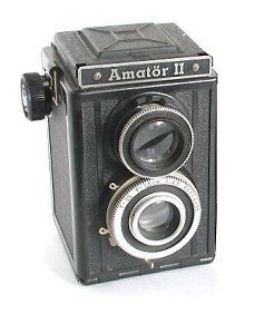

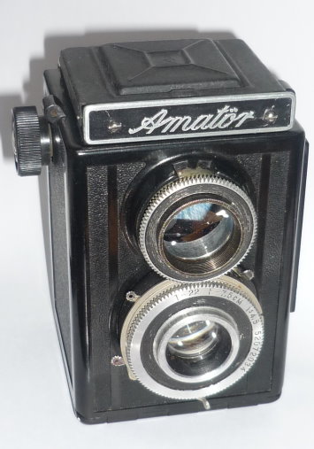

Hi all...
just a silly question....is this following camera, original or fake ?
(one bottle of french wine for the winner !)
(Michel is out of game Clown )
ah ah ah !!! have a nice week end Big smile !
alain
hummm sorry for mistake ...I try again :
Maybe both fakes because of the screws ;-)
These Amator cameras are not fakes. If fakes, you should know that there were announced in the Minicam Photographic magazine in 1947! as post war descoveries.
They also changed the name of the original Moskva to be sold in USA without any mention of the origin. Another interesting thing was that at that era there was an American manufacturer that offered a BC flash gun specially built for FEDs.
It was also true that Aeroflot had regular flights to Sweden from 1946, and business were active. Those cameras were also sold there as Pobiedas and Volgas. These last ones directly applied in taxi services with Igenor Sweden diesel engines.
regard LP
Yes Luiz, we know that the Amator cameras are a real model ... the question is whether the one that Alain is showwing in the photos above are fakes. I was saying that maybe they are because the name plates are attached with screws instead of rivets like the ones in your photos!
Totally wrong!!!!!!
GAZ-cars (not cameras) were not sold in Sweden, but in Finland, as we were not rich after WWII and our major export was wood and ships to USSR. USSR had no money so we got cars and much more. Bilateral trade, not free capitalism.
The diesel was french (not swedish) Indenor, also used by Peugeot. And not in old Popeda but in Volga. In the times of Volga it was no longer a popular taxi car, as western cars were also available. Only the old communists (dinosaurs) wanted Volga...
nobody won the bottle Big smileBig smileBig smile !!!

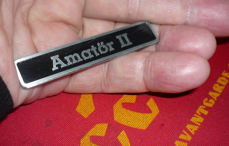

the first one is a fake ! I did it myself when I bought -and suspect- Sputnick II, and quickly discovered how to do....
So I meet a friend which had experience in printer plate and then we decided to make the same !!! (look at the types and spaces between...gently differents from originals -luiz pictures- )
after what, I make a second plate "amator II" :
it was very hard to find the same fonts (we had to re-design some of them , from a standard "Swedish" alphabet)
we used nitrogen acid on Zinc plates as for printers. then we polished this plate (soft shinning like aluminium)and varnished (spray)
If we used magnesium , the plate will be thinner and would look like better some aluminium.
Hard too, was to found roundish screws. ( truth is "Amator 1" screws are square /round and "Amator 2" rounded )
(note : the second picture "amator", I sent, came from Sweden and really correct whith original screws.)
Now I have to dig somewhere a Lubitel 2 and put my Amator ii plate to show another fake TongueApproveTongueApprove
So , why I did it as a collector ?
: only to prove how easy and cheap is to make "new" camera design whith this process (if you stay plates long time in acid you can control whith a chronometer the deep of emboss and even cut staight the plates (so the round wshers arround the lenses:
- first time you emboss the types (after drawing on a Mac) then you protect these types whith a varnish ,
at least , you put again in acid , to cut straight the round washers edges).
once again , when you have some doubts about such cameras : take a lupe and look closely at the types or drawing hedge : in that case they are 30° to 45° sloping , never perpendicular, as obtain in emboss process.
I hope the process clear for all , in spite of my so bad translation...Smile
