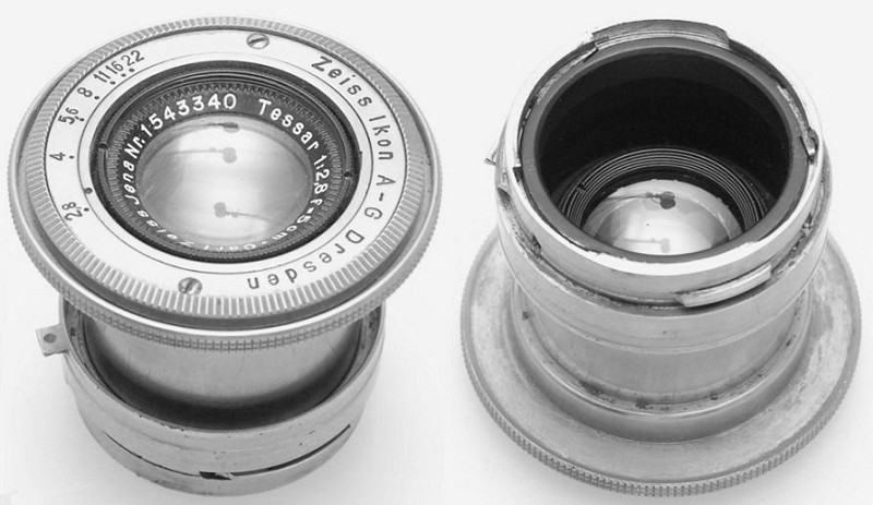

This is the lens:

Thanks for the photos of the lenses. It looks like the same as in the 1947 photo. But, was this type of lens made in Jena also?

You can see in the lens Jena N° 15XXXX Tessar 2.8 5cm
