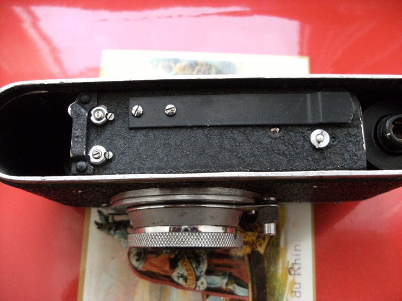

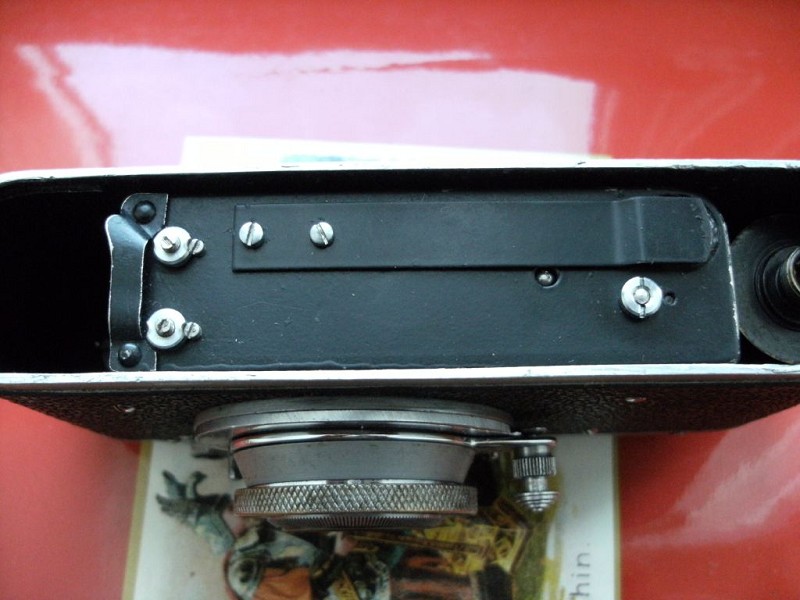

I have recently received my second 1948 Fed-Zorki.
It has the 1/500th of a second, and when the baseplate is removed, the paint of the shutter cage is not bright black, but like the zorkies (crisp?). Serial number of the camera: 02373.
My other Fed-Zorki, the 03278, has the 1/1000th and a black bright paint.
On looking on the net, all the 1948 Fed-Zorkies seem to have the same characteristics: bright paint and 1/1000th, or crisp paint and 1/500th. But is it a general rule?
And if we look at the wiki, it seems that the first Fed-Zorkies always have the 1/1000th (idem for the Fed-KMZ). Does it mean that KMZ first used the parts from Fed, and among these parts, there were mainly or only shutters of Fed S?
In that case, Fed would have made probably several thousand S shutters more than I thought (c.13000). And the real first shutters made by KMZ would be these 1/500th with crisp paint...
But I don't really know if I think "straight"! Tongue

I would find interesting if those who have a Fed-Zorki check their camera and tell if these hypothesis are right:
-1/500th sutter with a "crisp" black paint,
-1/1000th shutter with a bright black paint.
Thanks if you can. (and even if you cannot!Big smile)

1948 #2593 1/500 and semiglossy black, not at all as "bad paint" as in pic above
Falls between Jacques' two cameras timewise also!
Mine with 1/1000 of a second has also the FED style bright paint on the bottom. Built in 1948, serial number 2913.
Hello!
My 1949 Fed-Zorki, serial # 05159 has the 1/500th and crisp paint.
So, for the moment, it seems we can confirm the initial hypothesis: Fed-Zorki with 1/1000th have the shutter cage with bright paint. And those with 1/500th have crisp paint: what Junani calls "bad paint"Big smile
here are my two pense Smile:
First camera is FED-Zorki Nr.02198 with 1/500, the second one is FED-Zorki Nr.03454 with 1/1000. Both from 1948.
Hi Alexander,
When you say that the "first" has the 1/500th of the second, is it the upper or the lower on your picture?
thanks! Jacques.
the 1/500th is upper camera on the picture.
So, that's an interesting exception to the rule about paint! Big smile
It's the first Fed-Zorki I see with 1/1000th shutter and "crisp" paint.
