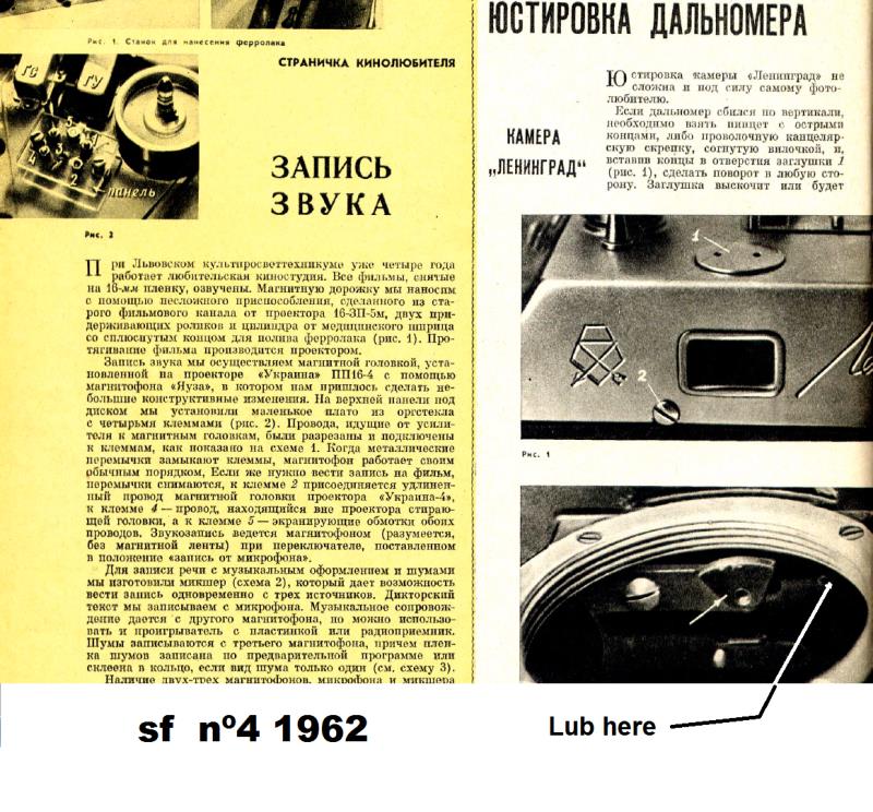

I have reassembled a Leningrad and taken photos about it (it's in german): <http://fotos.cconin.de/kameras/leningradrepair/index.htm>
The big knob with the spring can be opened by removing the two screws on the knob and pulling the knob. The spring sits in the housing it does not come out itself :-)
