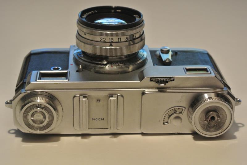

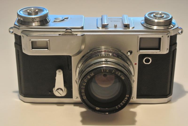

Here's a 1963 Kiev 4A that I bought only because of the s/n plate without 'made in USSR'. This is uncommon. S/n is close to others 'Kiev No Name'.
