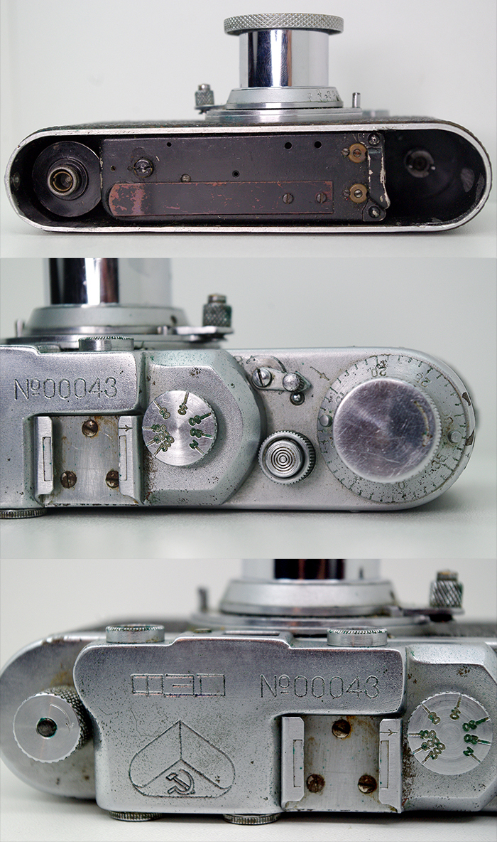

The photo of this Fed 1e is too bad to see correctly the spring and what is around it. However, we can see that the speed dial and the frame counter are of the Fed-Arsenal type...
The photo of the Fed-Arsenal s/n 00043 is much interesting. It shows extra holes for the screws of the slow speed spring and the connection towards the selector. It corresponds to those which can be observed on the Fed "B".
This Fed-Arsenal s/n 00043 could have been a Fed "B" in a better life... Note that these extra holes don't exist on any of my own Fed 1-s, nor my Fed-Arsenal s/n 00067.
