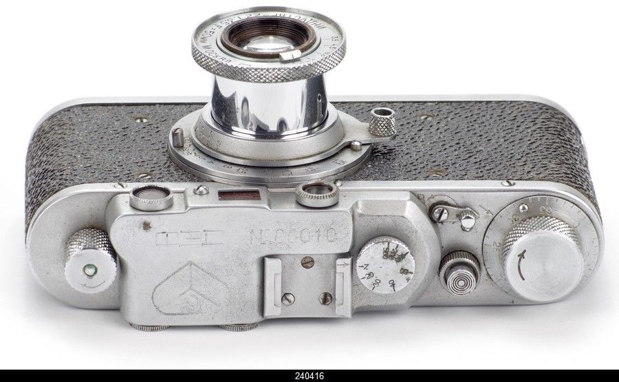

Another one, the s/n 00010:
Yes, and this "lovely" price - 8000 $
