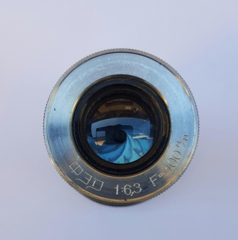

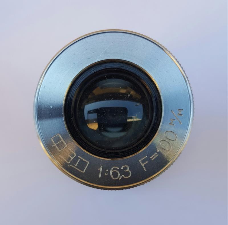

It seems that the lettering on the front of 100mm lenses can be different.
My friend PYC found that it is a bit bigger on his 37021 (without pins),
and a bit smaller on his s/n 33044, with pins:
It would be interesting to know if this change was made together with the pins...
(Fed 100mm lenses, series from 30xxx to 39xxx. Pins up to the middle only, around 35000).
Hello Jacques
From my limited data of 34 lenses,
#34376 is the latest # with smaller engraving, with pins.
#34521 has larger engraving, with pins.
#34942 has larger engraving, latest # with pins
#35975 has larger engraving, earliest # without pins.
So it seems no connection between larger engraving and pins.
(Also note different positions of colon and comma in each engraving)
Cheers, Geoff
#36310 larger engraving, with black filling, more to outer side of front ring than in absolute center
But what are the pins?
Thanks, Juhani.
Pins: the two small vertical screws on the crown, to help the owner to screw the lens on the body. There are pins too on the first 50mm rigid macro.
No pins on mine, neither the #14049 macro.
Stupid to leave them away.
