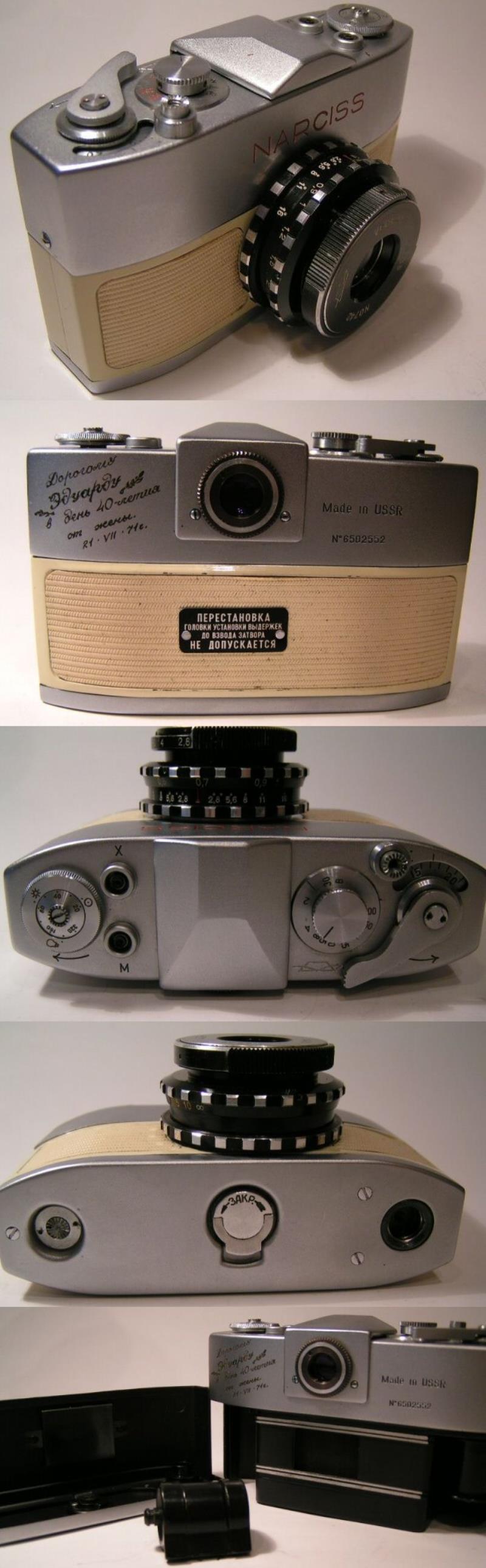

So I had an interesting conversation today regarding the beige export Narciss... the running theory is that these cameras didn't actually exist and all the export beige ones are top cover transplants from black ones to increase the value of the camera.
Here's a sample, but this seems to be a medical version with the plaque on the back..
Source: http://www.submin.com/16mm/collection/narciss/cameras/cream_latin.htm
Wanted to put this up for discussion. Any input is appreciated.
So this brings me to an interesting question which may support this theory of top cover transplants: This particular camera being a medical version has a presentation engraving on the back... Who would gift a medical Narciss? Smile

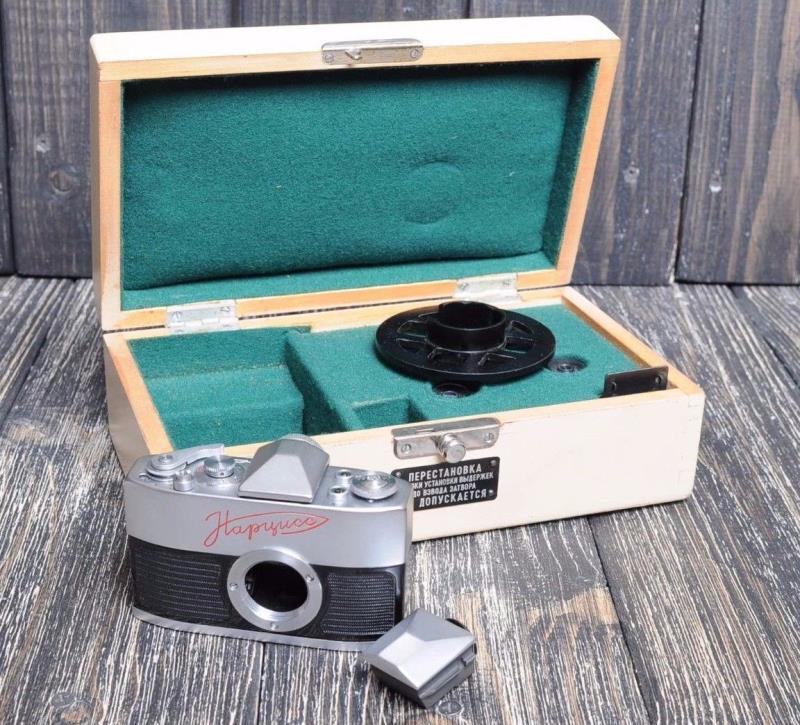

I bought this medical set couple of weeks ago (that's what this plaque is usually from):
This is from 1964... and beige ones are usually earlier years... the only two that are known which are beige exports are one in Viktor Suglob's collection #6502137 and this one pictured above #6502552.. I guess this begs the question whether there were late beige models at all...

If Narciss is equipped with a medical screen (prism), it's hardly suitable for ordinary use - it's not suitable for focusing.
Yuri, you make a valid point, gifting a 3-4 year old medical Narciss may make sense in economy where these things like that are hard to come by Smile
Žiga, you also make a good point but I think those can be easily replaced with regular prism, (and medical screen can be replaced with ground glass from a donor camera).. but I guess yeah you need a donor camera for it or make your own...

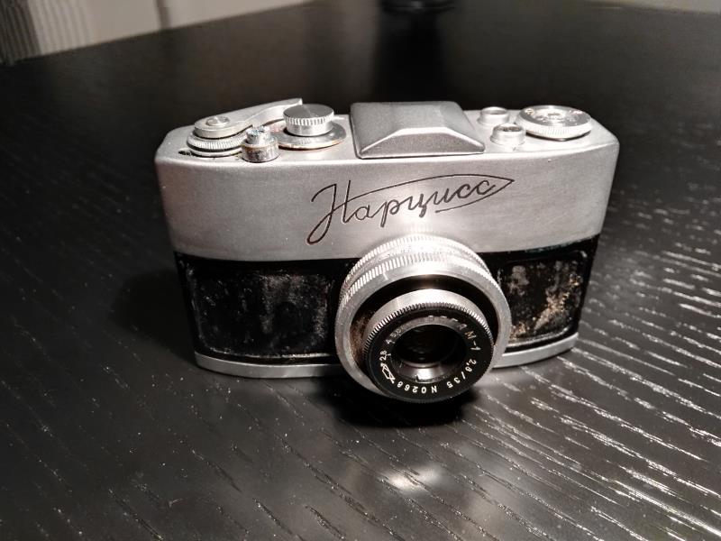

About the export engraving on this beige camera there can be many different opinions. My opinion is that this beige covering was simply remained from the old stocks. I have a transitional model from 1963. On this camera you can see some attempts to change the general look of the camera. I will take a photo of a camera and post it here in some hours.
So, this is my Narciss form 1963. Look at the inscription "Narciss". It is not only black, it differs a little from standard one.
Thanks Alexander for you opinion. that may be that it's old stock body... I'm comparing your narciss logo to mine, the only thing I see a little different is the Ц tail is a bit narrower than on mine, mine is more round...
