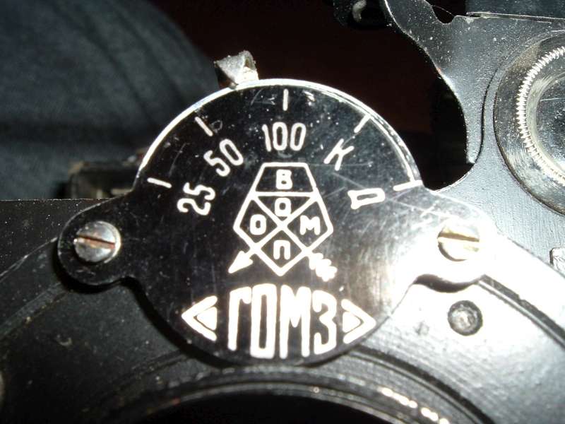

I have Fotokor questions:
I have 5 of them in my collection, and one has serial # on the lens which is 5513... but... when all my other ones just say Ortagoz, this one says Uvelichitelniy Ortagoz.. (Enlarging Ortagoz)... do all early lenses say that or I got some weird lens on it.. This is regular GOMZ shutter version... both lenses are13,5cm/F4.5... I also have earlier Compur unit but that one says VOOMP on it... so... any thoughts?
And also this one has GOMZ logo shutter on it, where all my other GOMZ Fotokors have VOOMP logo and GOMZ writing.. I need to take pictures... give me a few...
This is the camera in question below:
And this is my regular Fotokor 1 for comparison:

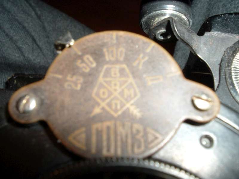

I only have 2 Fotocors. One with silk-screen printed labels on aluminum and second with stamped labels on brass. Second also has chrome focusing plate. Could Fotocors have regular and deluxe vertions?
Yea, I got that variation too, I guess I'm just curious about the lens... never seen the "Uvelichitelniye" before...
Vlad,
From the engraving on the shutter speed plate, your camera appears to have characteristics of FOTOKOR-1"C", according to Princelle's classification on page 34. Also, the photograph of bottom camera on that page has the same engraving.

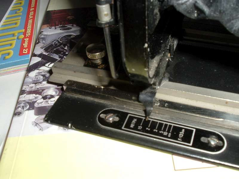

Bill: Thank you for pointing out the serial #!! I looked EVERYWHERE before I could not for the life of me find it... Smile.. ok now I moved the rails, the serial # is 207458 on the camera with the "Enlarging" lens..

If the serial number is that high, you must look at other attributes of your Compur-Fotokor to see if they match the early model. Look at the focusing index plate on the bottom flat plate, near or next to where you found the serial number. A different design of this plate was used on the early Compur models compared to later models. You can see this difference in the 3 illustrations in Princelle. It is easily possible to put a non-original Compur shutter on to a later Fotokor, either recently to get a better price, or in the past as the camera was being used, to replace the original Vario or GOMZ shutter. Also look at the shape of the metal fold out viewfinder which is different from early to late models.

You have not only an Uvelicitelni Ortagoz in your camera with a thinner bezel as you have a different engraving Gomz shutter. This seems to be one of the first models "All Russian" or one the trial prototypes used to be given to reknown photographers for trial of the camera quality.
As the lenses for enlarging are exactly the same, they used them also in Photo cameras. Those "Ortagoz" (should it be "Ortho Gomz"?) were one of the first produced. The all hand engravings prove that.
Fotokor are direct descendants of Certo cameras of the same vintage. Those CertoTrop were the best German quality/price offer.
Luiz, very interesting - a trial camera, eh? Too bad it's a modified RED version with soviet coat of arms on it (i'll add it to catalog soon).. But it's in great condition, I may actually use it to take some pictures with my rollfilm adapter that Bill was very kind to give me for xmas. Big smile

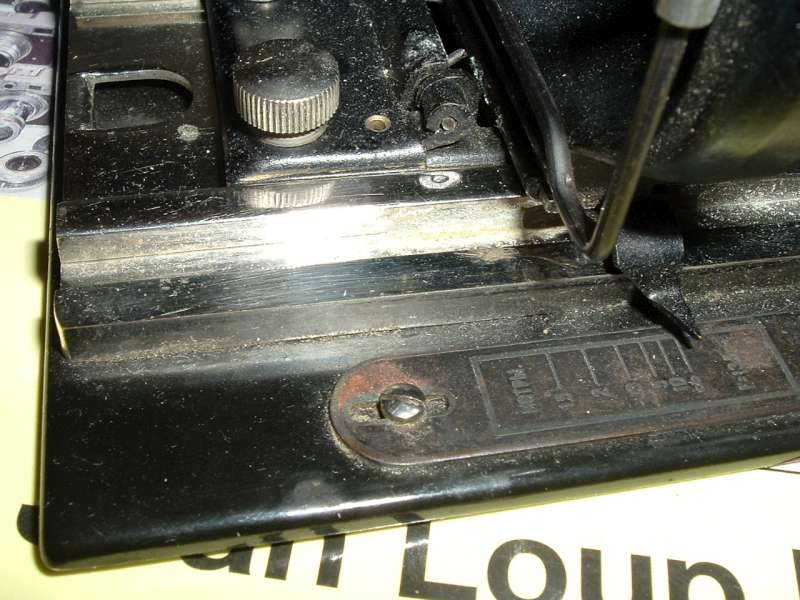

Hi friends,
I'm puzzled with my Compur Fotokor.
Like Vlad, I did'nt find thisAngry serial number. Reading Nightphoto post, I searched again and again.
Then I went to Fotoua and saw where the s/n should be.(Under the focusing plate)
So it appears that my Fotokor has none.Question
Some photos of this camera will help to identify what I think is a N°1…
All comments are greatly welcome.
Thanks to all.
Michel Smile
Hi Michel!
You have a VERY early one it seems, with the non-rectangular viewfinder and VTOMP stamping on the back. My Compur is #467097 and has the serial under the rails where yours doesn't and mine is hand-engraved and not even stamped. Also mine has GOMZ stamped on the back. Also you have a rectangular hole on the rails and not the semi-circle which also points to a very early origin. My Vario version of Fotokor (albeit already with square viewfinder) has this same rectangular hole.
So it's very possible they weren't even numbering these at the early stages like you have. Very nice find! Congrats!
