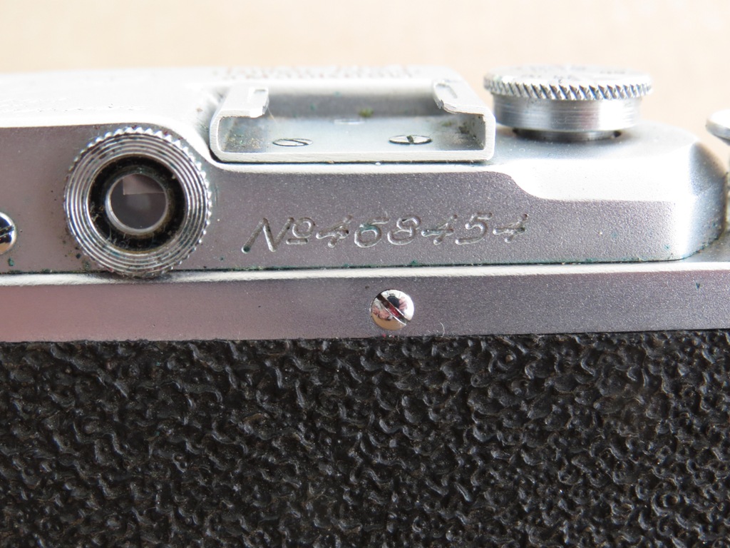

I have found the s/n 466624, lens s/n 3874.
This camera just takes place between the two batches of Fed anniversaries. It is an ordinary 1g: interesting news to limit the number of "anniversaries".
I will post photos when it is here. (added in the wiki).
Thanks, Alexander.
It's very probably a fake, like the other one you had previously quoted (main feature: the open "4").
So, my s/n 466624 is here.
Nothing special to say about it: it's a regular Fed 1g.

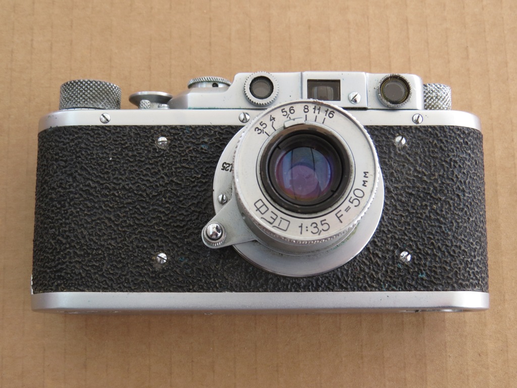

Two photos:

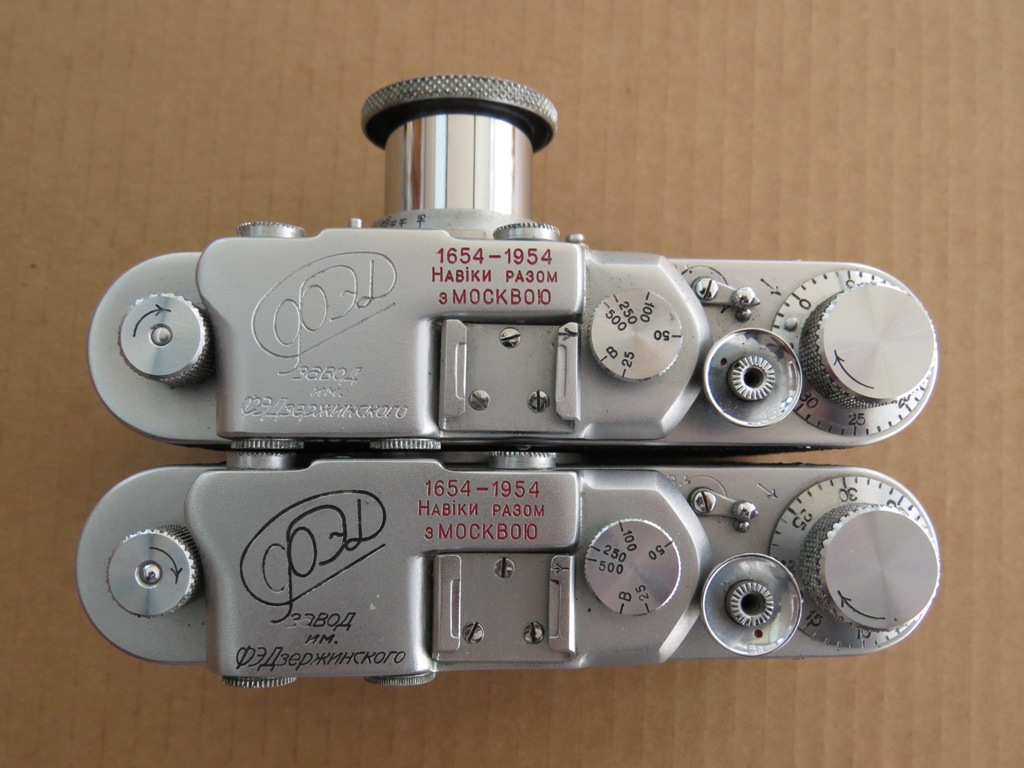

If I compare a 1f-2nd series and an "anniversary", the logo and the factory are strictly at the same place.
So, the easiest way to fake an "anniversary" is to use a 1f, second series (with number, logo, and factory on cover), to erase the number, replace it by the red inscription, and add a correct serial number on the back of the cover.
Probably Fed used non-numbered 1f-second series covers to make the "anniversaries"...

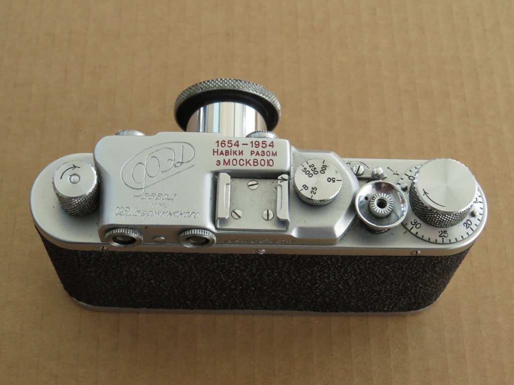

Received this morning a Fed "anniversary", second batch:
As already noted, no other difference than the logo in black on the first batch:
Other photos if useful.
Amitiés. Jacquers.
Hi Jacques, congratulation on another rare camera addition! I did notice unfortunately that these black-filled engravings were filled with black or red (in some cases) after the fact to embellish the cameras, I am somewhat doubtful this is a factory feature.
By what I have seen, all the cameras of the first batch have a logo filled in black. And none of the second batch.
That should mean that all that was factory made. But that must be checked... So, comments are welcome!Smile
Jacques, to be specific, you're talking about first batch of this particular anniversary camera?
Thanks, Ulrich. That confirms what we can suppose.
Vlad, to be clear, I was just talking about these specific Fed anniversaries. It seems that the cameras belonging to the first "batch" (s/n around 465xxx) have the logo filled in black, whereas the second batch (s/n 4684xx) don't have black in the logo. Of course, the anniversary inscription is always in red!...
It's probably a factory made difference, contrarily to some other Feds with added black or red colour: I agree with you.
