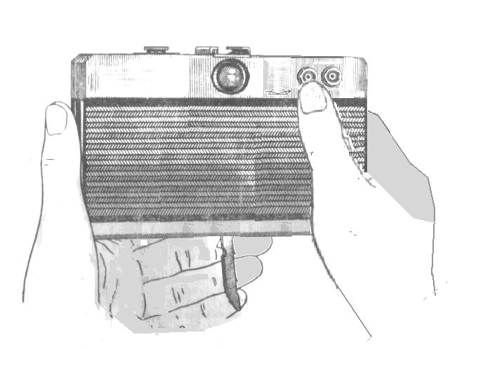

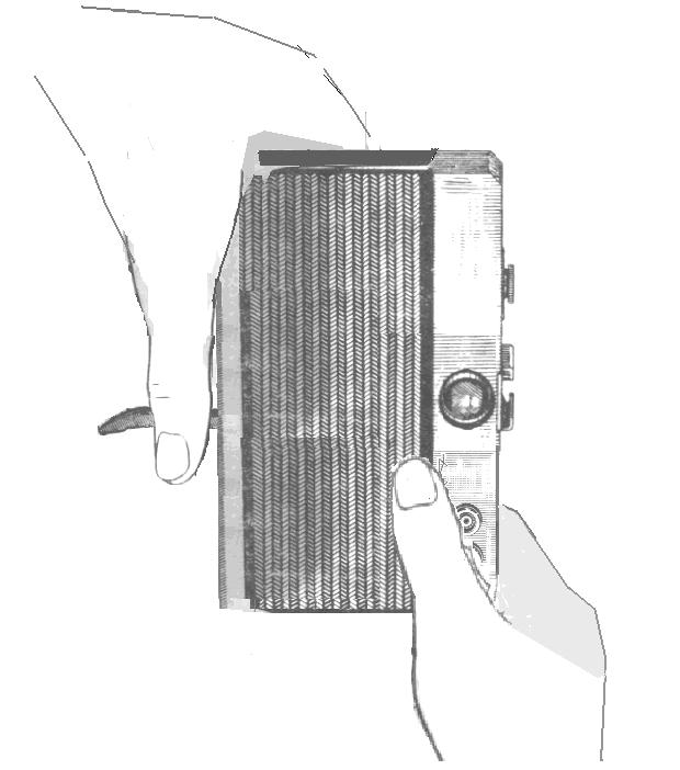

Thanks for the pics Luiz, that is most helpful. I have got my first roll back and I quite liked it, but I have found cocking the shutter and keeping the camera relatively in frame to be somewhat ackward as I have a tendancy to want to cock with my right hand. This way seems to work much better!
Thanks again
