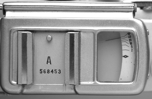

If this can bring "water to the mill", here are three photos of three Kiev III cells :
As you may see, the graduations are somehow different…
Michel.
GOSTs have to be revised after some time. This means that GOST for tolerance of light meters may exist in 1954(production year of the lettered cameras) and then GOST was revised in 1968 and 1979. So letter may belongs to meter, not to the camera, but that also means that all Kiev 3 from some period in 1954 have to had this letters. Is it coincide with our database?
P.S. GOST-ghost something spooky and mysterious, like in real live it was. Smile Smile Smile
Michel,
by the way, look at the different meter scales. They are the same on A engraved Kievs, but different on the B engraved one :-)
Ulrich,
Yes !
That's the reason why I post the photos.Smile
Michel.

Originally posted by uwittehh
Michel,
Hello, my 1954 kiev III 'B' camera has the same scale like Michel's 'A' Kiev III...
