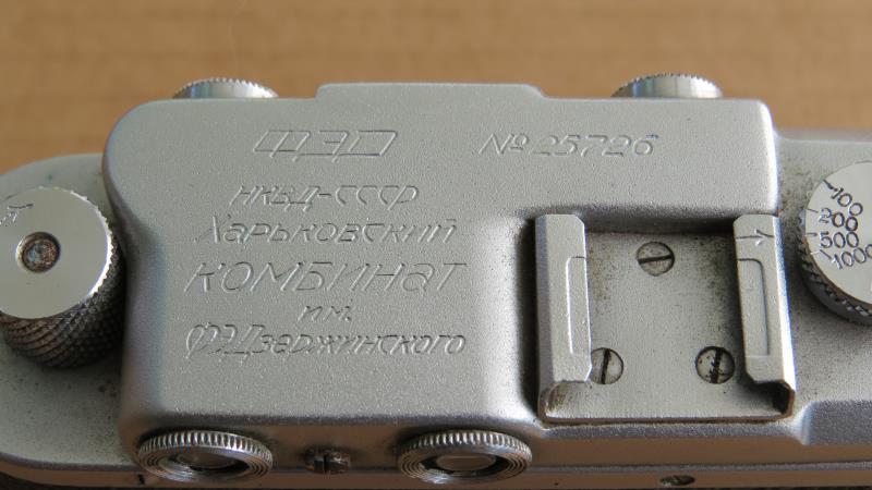

I have received yesterday a strange Fed S, s/n 25726. Its features are from the NKVD 1d type, but the number comes from the 1b series. It puts once more a question which has not been solved: why these serial numbers? I own several of these strange NKVD-s (I am not alone!) and perhaps we could discuss together about mine and yours...
First some photos of this Fed S s/n 25726: the cover and the front.
Nothing extraordinary, except the s/n. The vulcanite is typical of the early 1d-s (I would say up to c.110000).

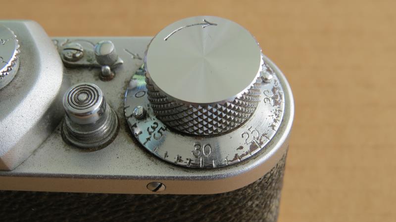

The frame counter is magnetic. It's probably the first time I see that on a Fed. And the position of the pins is correct, so, this disc doesn't belong to other well known cameras, such as Leicas or Zorkis.

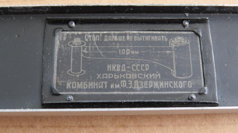

Something else. The bottom cover contains a special warning plaque like some Leicas, but in Russian and with the "CCCP" mark. A sort of 1d identity card... I had never seen that before.

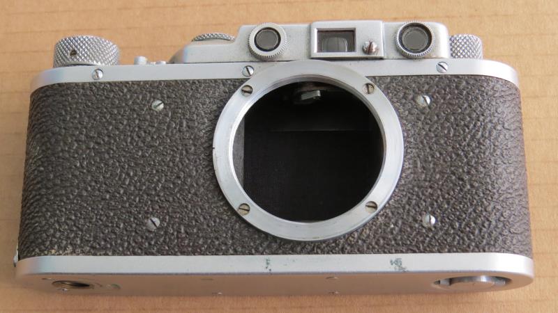

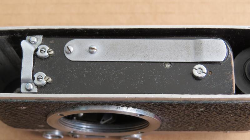

Last picture concerning this camera: the back part of the shutter box, foot removed.
Of course, interesting. Impossible to say where the grey colour comes from.

The little plaque inside the bottom cover is quite surprising, I've never seen one as well! How interesting! I am still of the opinion that the early serial numbers of later cameras are a result of a factory warranty repair where number was moved to another plate so the passport stays the same. Very nice and curious addition to your collection! Congratulations!
Thanks, Vlad.
The factory warrantee repair can be an explanation for some of these cameras we already know. But not for this specific one, I think.
This s/n 25726 belongs to the early 1d: CCCP engraving, non magnetic shutter cage (cages become magnetic from c. 110/115xxx), vulcanite, etc. So, a theorical serial number between 95xxx/115xxx. These cameras were made in the mid of 1939; the original 25726 1b in the end of 1936 (Princelle). It's too long for a simple warrantee.
I even think that the misengraving (omission of the first cipher, a "1") is probably not the explanation. 125726 would be too late for a 1d with a brass shutter cage. And more: the magnetic counter frame and the special warning plaque are completely unusual.
So, a special series? Or rather bodies, taken from the running production, to be re-numbered before delivery? But to whom? Only a supposition...

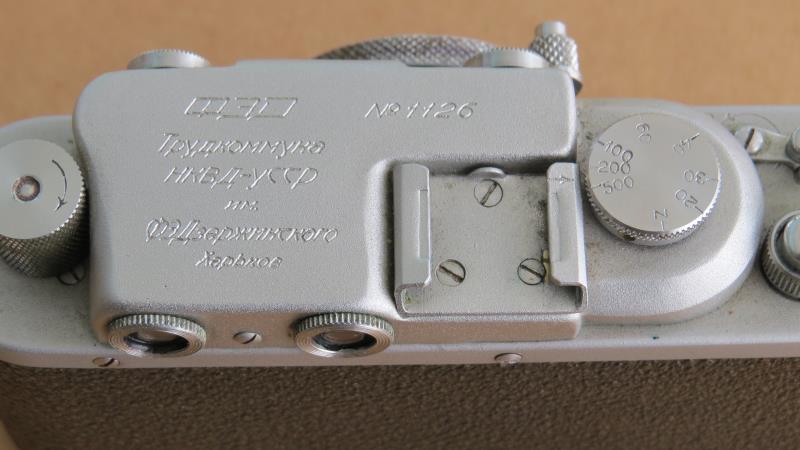

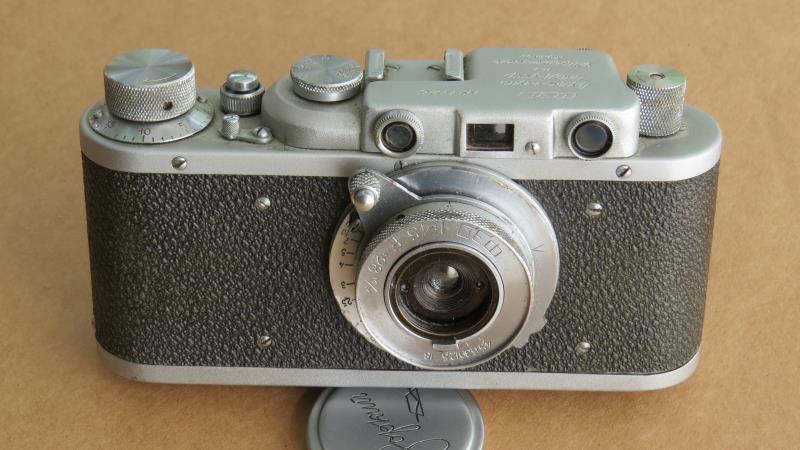

Second camera: the s/n 1126.
A normal 1b, except the number.
The vulcanite takes place after the brown patterned one; narrow inscription, fine milling for the buttons, no hole on the back.

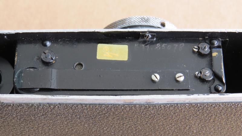

Base plate removed:
The center screw is present. There is "25078" written with a pencil on the cage (perhaps the s/n of the original 3,5/50 Fed lens? I bought the camera with the 4,5/28).
All in all, a classical 1b which should have a s/n between 15xxx/21xxx, if we add the shape of the left side of the cover (much more curved after) and other details. This camera seems an excellent candidate for the 1st cipher missing: "21126" would be normal for this body.
Any comments are welcome! Thanks!
